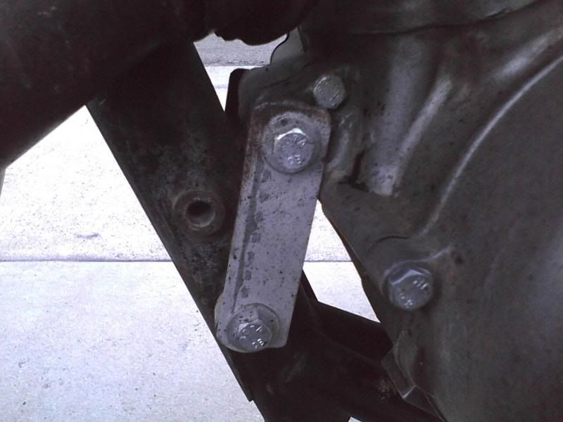

    Ok so I'm going riding in Glamis tomorrow one way or the other. I'd love to bring my Tecate (with the LT250r Suzuki engine) out for my first desert trip on a trike but I'm a little concerned because it is leaking oil from the crankcase. I road it up and down my street and each time there was bout 4-5 drops of oil on the bottom of the engine on both sides. Is it worth going riding this way and just bringing extra oil or should i not risk it? Also, where the exhaust connects to the engine its leaking oil out of there slowly because the seal is like non-existent if there ever was one...
    A separate problem I'm having is that when the bike idles for about 20 seconds or more the RPM's will start getting higher and higher, I haven't taken the carb apart yet but I'm guessing it could be a float problem, what do you guys think?

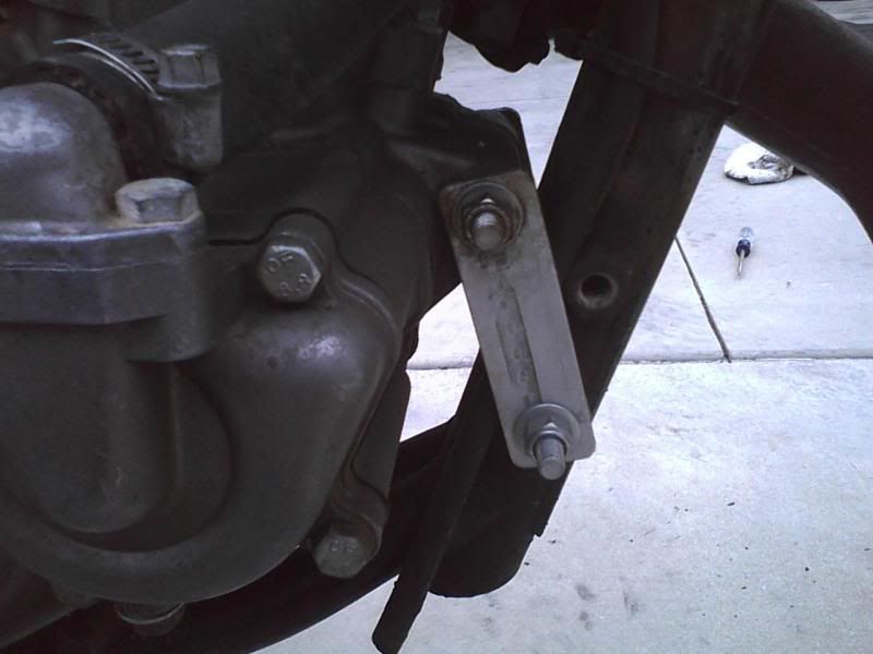

    I also have pics of the engine mounts because someone was asking how it was mounted in a couple days ago since its not the stock engine.
    The bike is ride-able but I don't want to jack something up if I can help it
    Oil around the wires?
    Oil on the bottom of the case along the housing seam
    Homejob engine mount? I could do better than that >,<
    Other side of mount

    Well the way I see your pics is the leak is from the counter shaft sprocket seal and the oil is getting slung all over. Or is it from inside the stator cover? If counter shaft then no big deal. If from inside the stator cover then you could have an vacuum leak.
    I would say a 2 point motor mount is not ideal.

    Yea that what i was thinking nd4speed. I saw those and i was like... wow thats pretty cheesy. I'm looking into an add on Craigslist for a working "84/85" engine and he has the pipes and all that. If i can get a good deal for it i'm gonna either machine up or buy his engine mounts off the same guy and fit that all together. We'll see how it works out. I offered him 350 for the engine and pipe and he wants 475 total for them.
