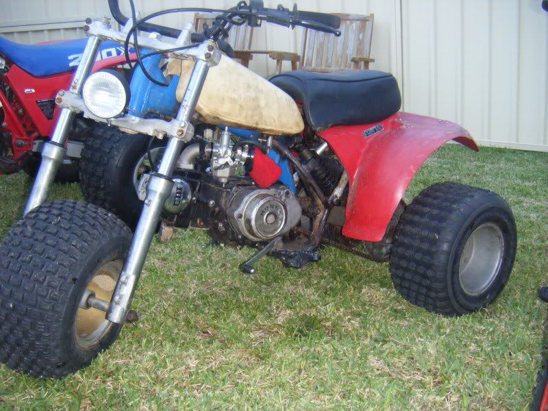

    Here is one done in Australia by the expert mad scientist mart.
    Here is a link to what his next plans are for it.
    http://www.ozatv.com/forum/viewtopic.php?t=13173

    http://www.ozatv.com/forum/viewtopic.php?t=13029

    prety badass..now u just need to slam a R motor into it
