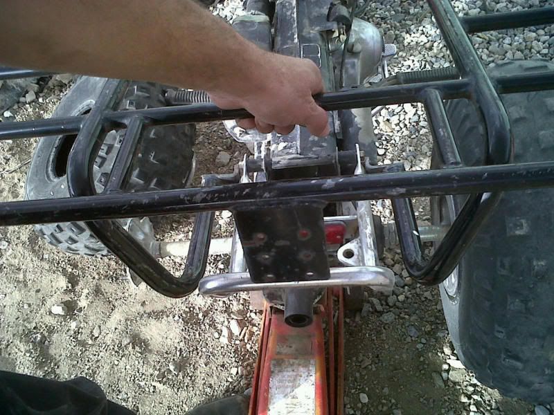

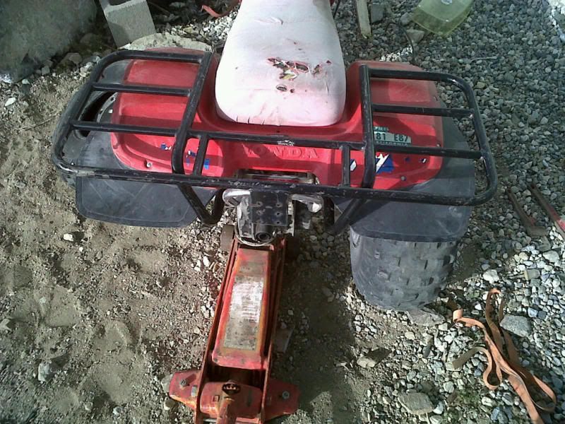

    Hello,
    A friend of mine just gave me a cargo rack for a Yamaha (It has a Yamaha sticker on it). Interestingly, it looks like it will bolt right up to the little wheelie bar that is on it right now.
    Can anyone please send me a picture on how their stock Honda rear cargo rack is bolted to their ATC 110?

    They won't interchange. If you look at the honda 110 the upper and lower mounts are different widths. If you look at the yamaha rack, they are the same width. Unless you are talking about the unit that just bolts to the grabbar on the back of the trike, but real honda racks bolt to the same area the grabbar does, you have to remove the grabbar and replace it with the rack.

    Strangely, there are no lower mounting points, only a hitch looking thing.
    I am able to weld what is needed.

    That may be a yamaha ytm200 or ytm225 rear rack. It's definitely not a ytm125/175 rear rack. A honda rear rack would mount just like the honda rear grab bar.
