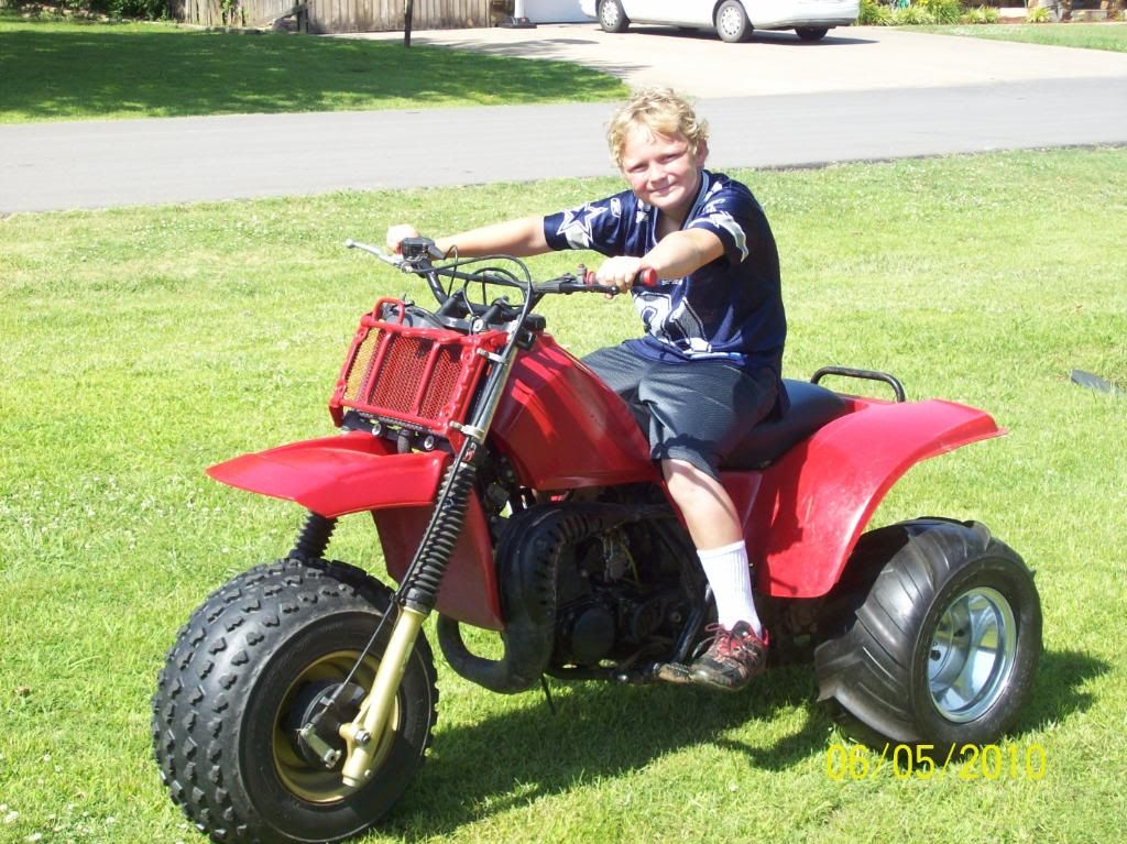

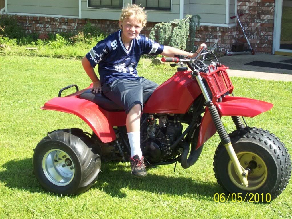

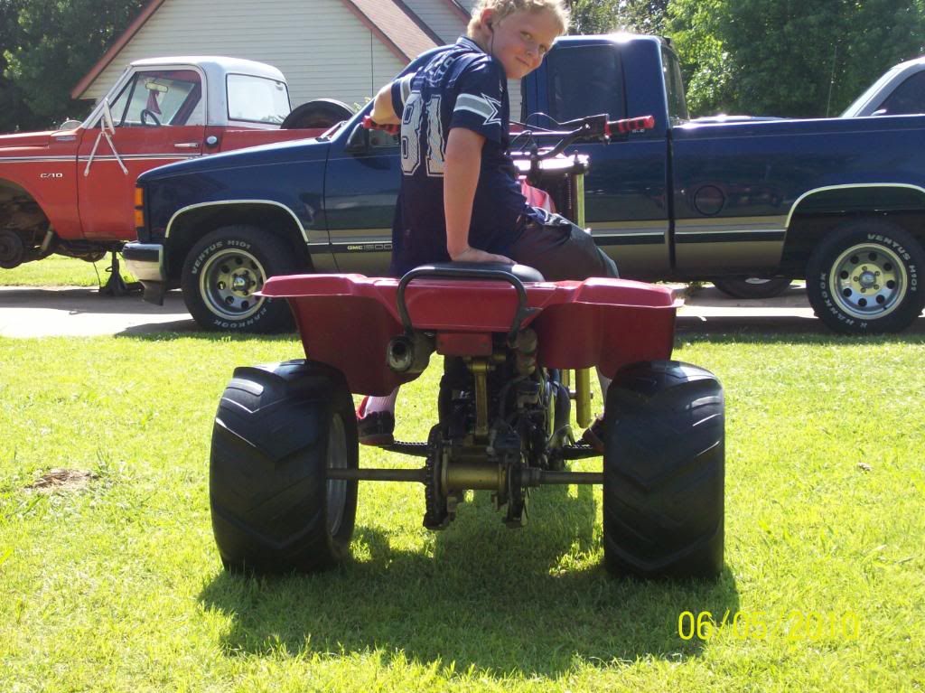

    ok so i'm gonna link pics..... i have the stock wheels too they match the front one i had to see what the paddles and polished looked like lol
