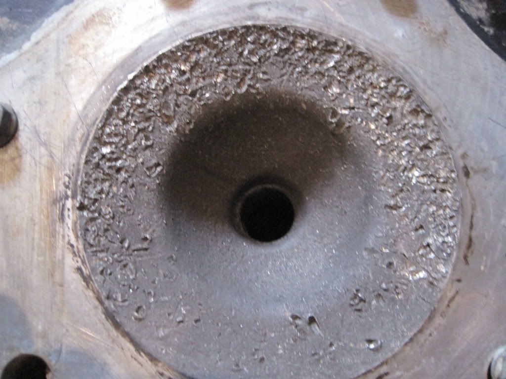

    I found this little surprise when I took the head off, but nothing a little head decking and chamber resurfacing can't fix

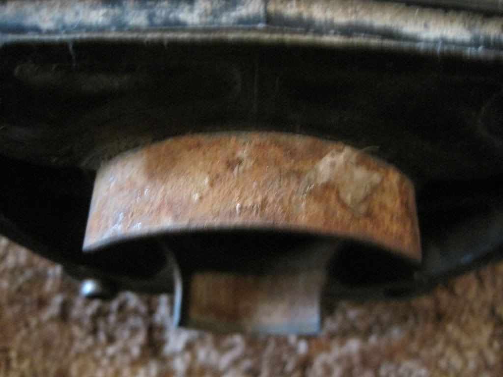

    The cylinder is pretty banged up, but nothing a little cylinder boring can't fix

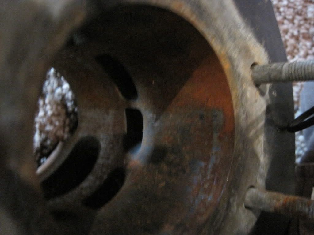

    You can see where the piston got lodged in the cylinder bore
    Do you think I could just use a buffer wheel to clean the cylinder skirt, or would I have to buy a whole new sleeve

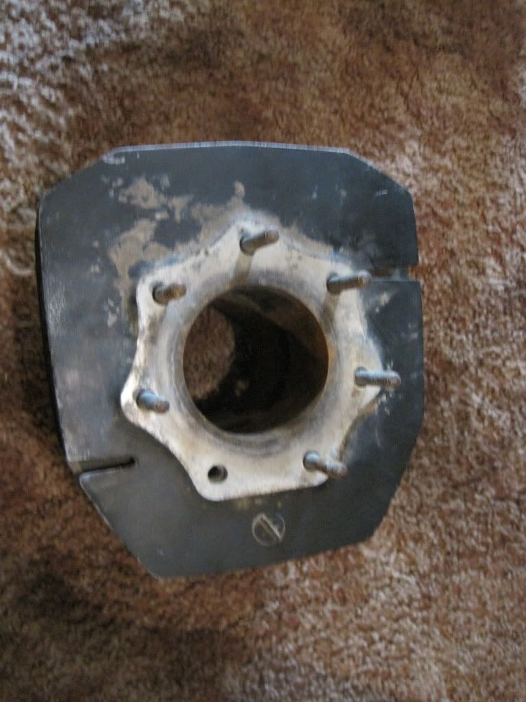

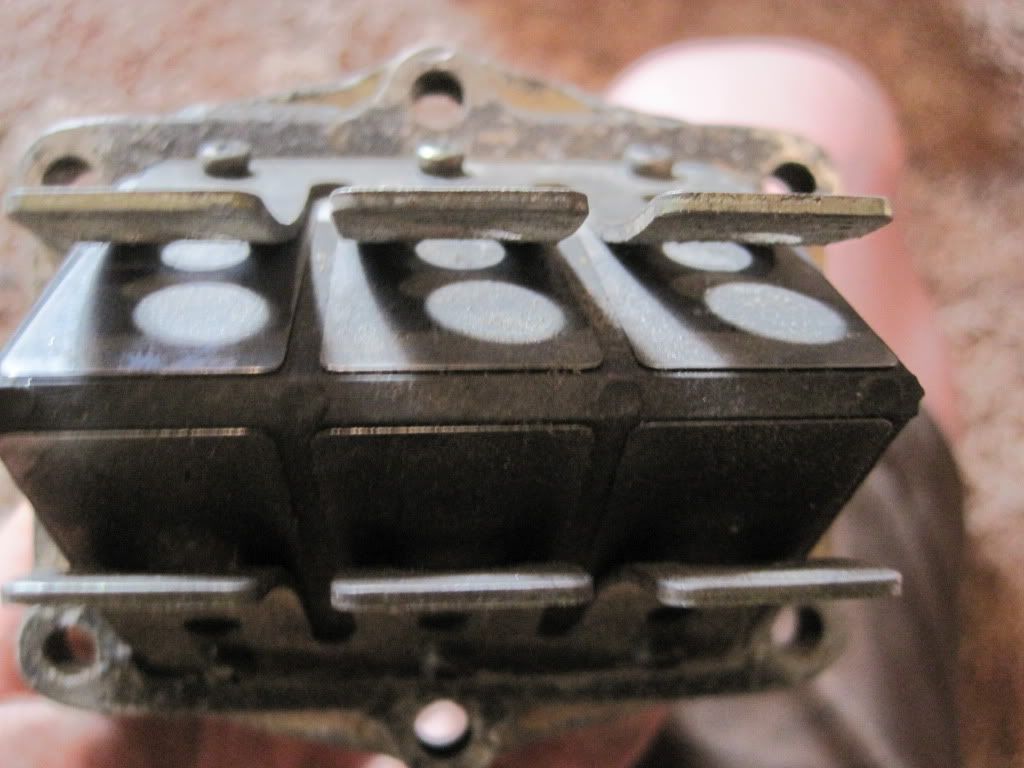

    I have never seen steel reeds, nor have I seen this kind of setup. So can you guys help me identify this kind of setup and brand?

    Stock 250r came with steel reeds like that. I'd guess they're just stock?

    I did some digging and your top end isn't a Mugen. The Mugen cylinders were stamped with Mugen on the side with the Kanji and had 6 bolt cylinders. The Mugen kits came as 250cc or 360cc kits. Your cylinder has 7 bolts. I found an ad that looks just like your top end. It's a Dico 300R kit. Here is the ad.

    300 air fooler sleeves and kits gettin a little rare? If you love it, fix it and ride it, or you could part it out to fund a waterpumper build!
    I have always wanted a 1986 250R. But all the nice and cheap one's are over 6 hours away from me. As for the sleeve I think I could use a kustom kraft sleeve.

    I'd put a new sleeve in it and run it. Regardless of it being Dico, which was an awesome company back in the day. I'd say it's pretty rare and should be stout too with the 7 bolt cylinder and head. You've still got a 300R, and for the price you paid, you still got a serious deal. I wonder if it would take an overbore?

    I'm pretty sure it will take a over bore. I'm hoping maybe 20. over. Also can you tell me if I can just use a buffer wheel on the jug skirt? It's pretty rustic. Just look in that one pic.
    OK
    5,450
    I don't see why you couldn't as long as you don't remove more material than the original od of the sleeve. I had a thought, what about electrolysis? I haven't used this method myself but people I know who have say it's nothing short of amazing.
