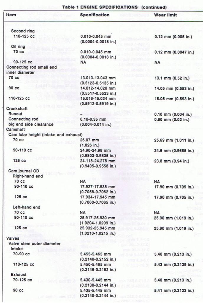

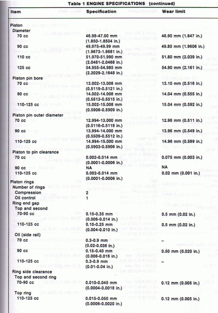

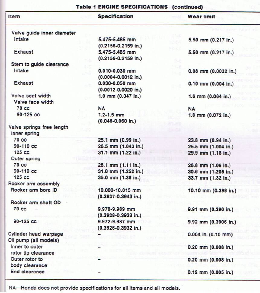

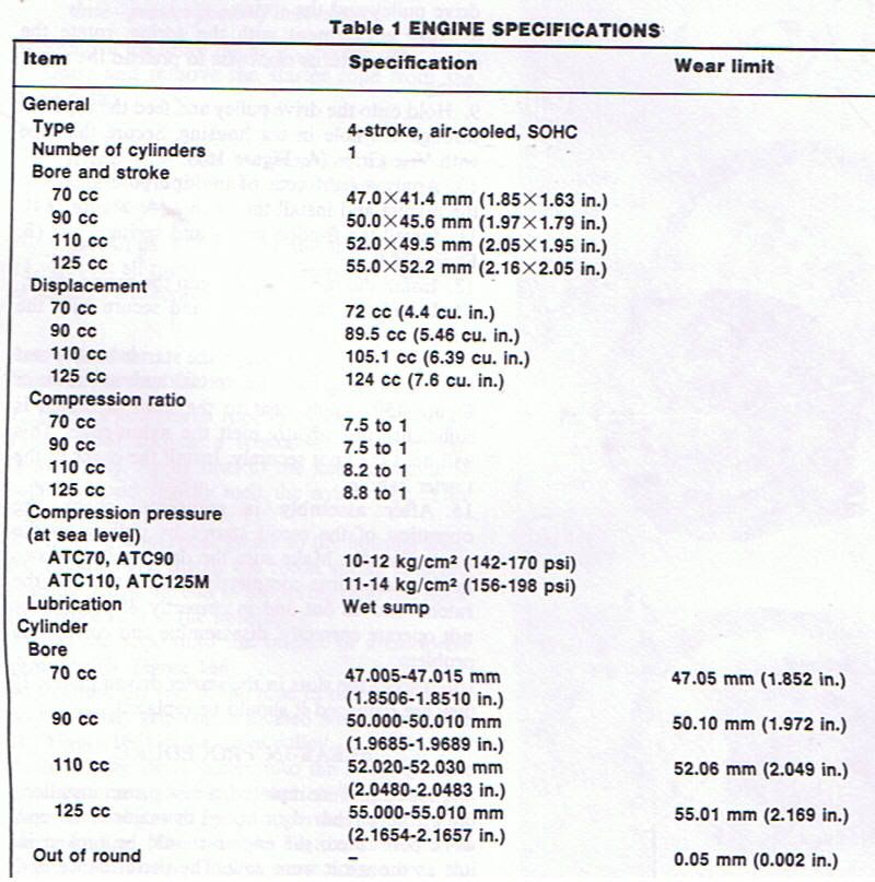

    Thank you all for responding, i decided to take a closer look, I started taking the engine apart to look at the timing chain...turns out one of the bottom gear is pretty worn out and may be the source of the noise.
    Does anyone know where I can get engine specs? tolerance, torque settings etc...
