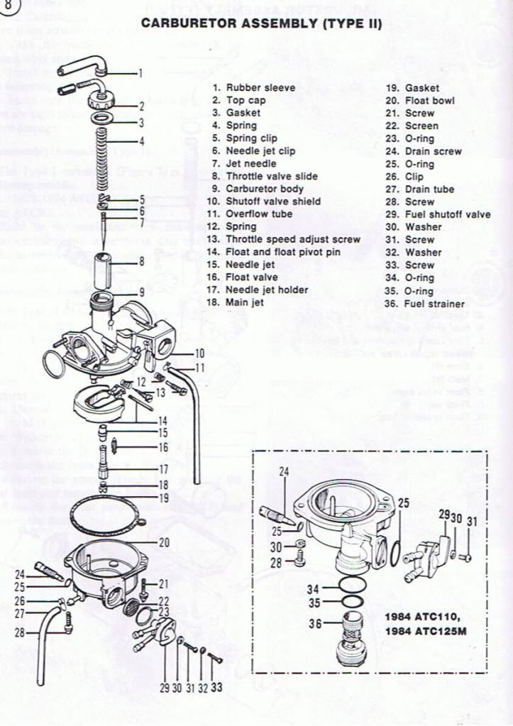

    i finally got my 110 to start and idle but it only runs on choke, and if i rev it it dies. and i adjusted some needles to no avail, and theres one screw needle on the bowl of the carb that is all the way in and if i take it out maybe 1 turn gas runs out of the drain line of the bowl. can somebody tell me whats wrong with my carb and tell me what needle does what cause im lost as far as carbs go.also my starter rope keeps tearing anybody got a remedy for this too. thanks nissan

    get a new rope. as for the carby, if it will only run with the choke on it means that its running lean. need to make it richer. you can do this by either lifting the throttle needle up (on the throttle needle you will see an E-clip you can adjust its position to make the engine run richer or leaner)and/or winding out the pilot screw a turn or so. see exploded diagram below.

    No 24 is the drain screw. Maybe that's what you backed off and fuel came out?
    If it will only idle with the choke on, the carburetor may have idle passages plugged and need disassembly and cleaning.

    i got it to run off of choke for a bit, but it went back to only running on choke. what is the e clip setting for the jet needle its on the 3rd place on the needle from the top is this right for a 110? update soaking carb in sea foam see what that does.

    if it wont run while its spose to be idleing you need to adjust the pilot screw for now, not the throttle need just yet. wind the pilot screw out about halfway or so and see if it will run with the choke off. if it still wont run try winding it out abit more. when you do get it to run with the choke off, you need to wind the screw in until it start to misfire then stop. wind it out abit until the engine has a stable idle.
    for the preliminary adjustment for the pilot screw - put the trike on level ground, wind the pilot screw in until it seats LIGHTLY then wind it out 1 and 1/8th turns.
    to answer your question, the 3rd groove is the normal setting. the high two settings are for higher altitude.

    soaked in carb cleaner all night, cleaned all jets spotless and it now runs off of choke. but lacks power to pull in 1st gear in low so to ride it i have to put it on choke to ride it.But heres the interesting part and somewhat weird, the pilot screw on choke or off of choke does not change the way it runs,in fact i can take the pilot screw all the way out and it still runs.Whats up with that? please someone help im so anxiouse to ride with full power in the motor and i have cheacked the connection between the aribox and the carb its tight.Thanks

    firstly only run the engine with the choke off when getting the correct settings for the carby, also wait for the engine to be up to operating temp. just for a base setting wind the pilot screw all the way in and then out 1 & 1/8th turns out. and the throttle needle on the third groove. if it lacks power, change to the bottom groove, then see how it runs.
    also have you checked the jet sizes? 85 main and 35 slow.
