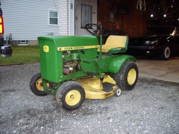

    My machine is a 1968 John Deere Model 60 as stated in the title. I was mowing my lawn last week when one of the tie rods came apart. The ball fell right out of the socket and I would gladly just buy another tie rod but I cannot find one anywhere. I think the part may be obsolete, but I don't know because I can't even find the part number for it. Any help would be greatly appreciated.
    This is what my tie rod looks like. Unfortunately, this one is too short. This one is 8 1/4 inches long. Mine is closer to 10 inches or so.

    My 316 has a simple tie rod setup like that and I made my mind up that if an end goes bad Im using 450R tie rod ends and treading some rod so it will look just like a quad setup.
    You could even just get a quad tie rod and cut it in the middle and shorten it to the width you need. Then when it nweeds an end you can just get quad parts...lol
    I just rembered, I do have a pile of old tie rods from suzuki quad sports with ends if i remeber right. I'll look around and try to find them and post a pic. I know I have one around 10''.

    HA! went right to them.
    Here they are, 1 is just under 10'' as it is ajusted now and the others are longer. If you want one to use I will sell it CHEAP.

    Thanks a lot Swigin. I was debating on doing something like that myself. The thing that makes it tough is my on going garage construction. I don't have any access to my welders so I can't really fabricate anything. It would have to pretty much bolt in. Let me see what I can find out and I may take that 10" one off your hands. Thanks a lot for your help.

    I broke a tie rod end a couple years ago on a real POS mower that my buddy gave to me. I stuck the two parts in a vice and crimped them together. After that I wound a lenth of wire around them to keep them together if they ever fell apart again.
    It's still holding! Lol!

    If you tell me the corect measurment I will cut one down and weld it for you. Or I could add a section to the middle to lengthen the little one.
