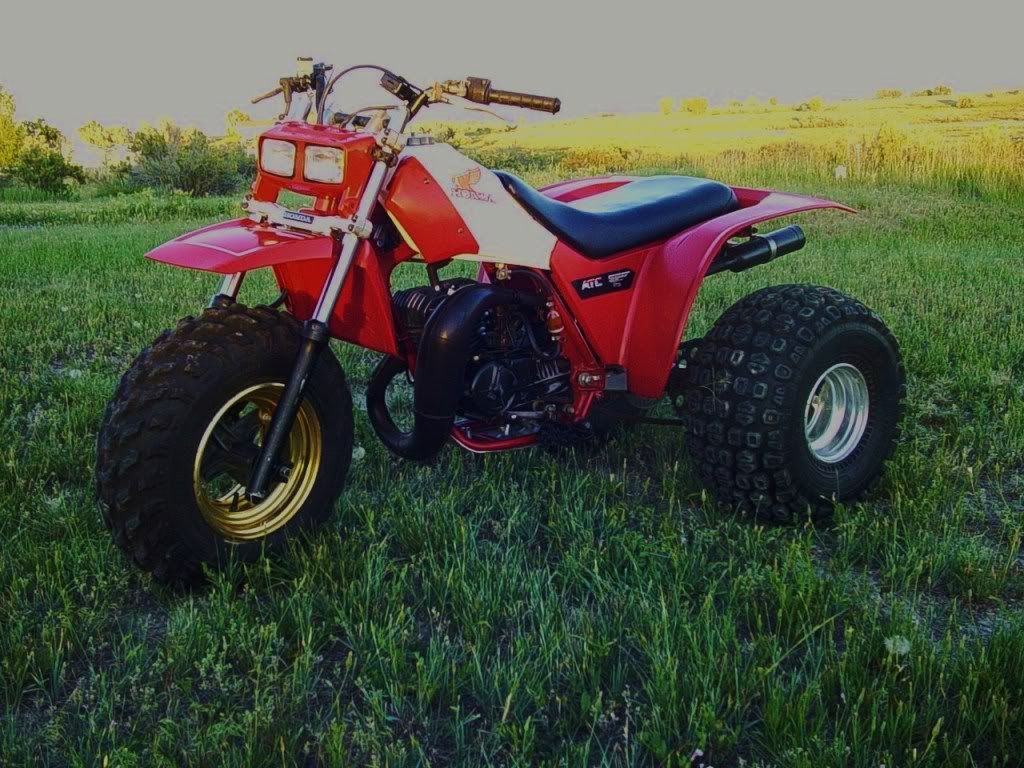

    My 200x is coming right along.......This last weekend did some testing and made some change in its stance........now It's working very well
    [IMG][/IMG]

    Where'd you get the engine from?

    It's from a 1975 mr175 Elsinore.........It was almost a bolt in .............Ol Deuce

    Looks Sweet!!

    VERY nice looking!! Take the seat off, show us her bare arse!!
    Sweet! If I find one, i'm going it

    O.k., this ain't fair Ol Deuce. You hardly gave us anything. Is it fast? Or should I say how much faster than the 200 4-stroke? Where are you?, I want to see it bad. How cost effective? What degree of modification are we talking about? Don't be a tease.

    She pulls as hard as she can in 3rd gear ,4th & 5th are way fast....................

    Honda~Honda......The blaster is the same design as the Elsinore....... not much to gain 25cc?? the blaster is a forward kick and the Elsinore is a rear kick

    Your 200x has low rpm torque and the 175 2-stroke pulls at the higher rpm ,hp of the 200x is app 15 hp the 175 is app 17 hp .The 175 smells and sounds good ! what else ? yes it
    seems to have a bit more top-end faster over the 4stroke. The cost to make this change over was $???.?? I always pay too much........but it was worth it ! The degree of modification ?
    well ..it was fun! Ol Deuce
