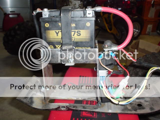

    Lancaster, PA
    1,738
    You will need to use a pitbike exhaust orthe Cobra under exahust. Asfor the battery. youmake up a mount on the skid plate, you have to remove the cross member inside the frame.

    indiana
    64
    Blue27 that is a nice looking setup for sure! Thanks for the pics! Will a crf 50 exhaust work ok? I don't want to have to cut away any of the fender plastic. What amp battery do I need? Thanks again!!
