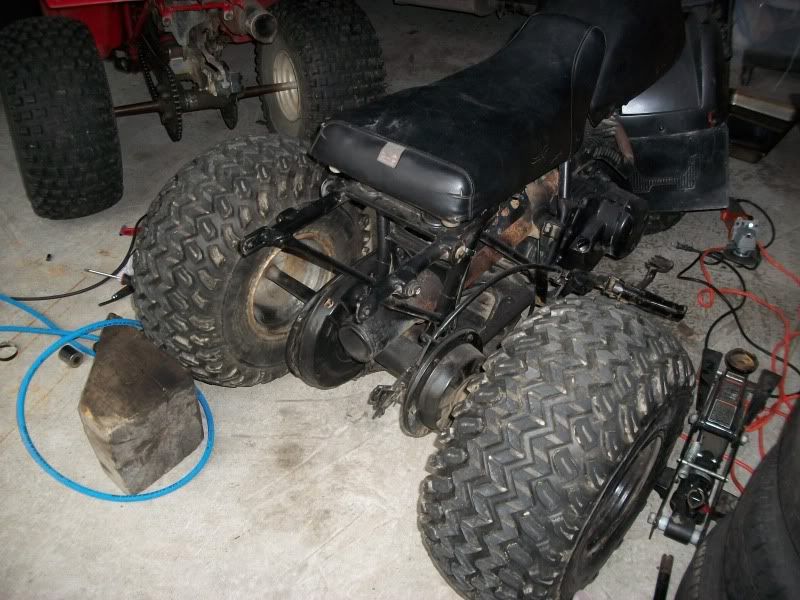

    here's the good:
    the trike runs great
    here's the bad:
    the last owner spray painted everything black 4 years ago and has no paperwork
    i cant find a damn number on the block, head, frame, near the handlebars AHHH
    the main reason i need the model is because the spark advancer currently has no springs, but it still rides fine but id rather replace it
    so fellas how are there ways to identify my gfs ride??
    the owner told me he THINKS its a 1983 200s (has pullstart and is an automatic)

    god damn alright, im watching jeopardy right now but next time i wander out to the garage i will snap a pic
    also he cut off all the fenders and the seat has been shortened

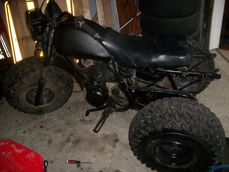

    84-86 was the 200s.
    (IF CHAIN DRIVEN) If it's an 83, it's an ATC200 or ATC185s. If not an 83, could be an ATC 185, 200s, 200M, Auto 200X conversion, I think the 200E was shaft drive?? Or a 200es if shaft driven. Could also (but doubtfully) be a late model (86-87) 200X with TRX 200SX quad engine.
    If it has 22" tires and you believe them to be stock, it's a 185 or 200 or their 's' models. Front shocks on most of those, no rear shock.

    exhaust is out the rear, its a hard tail (no rear shocks)
    pull start
    automatic

    Looks like a 84 200s to me, It shift down to go up a gear? or vice versa...either way it needs some tlc

    185s/200 1983?

    it shifts downnn
    if you mean tlc because its ugly im not changing anything, as long it runs well im happy, i ride these things out in the fields near my camper, they dont need to look pretty

    Most likely a 200s...Judging by the front forks, headlight, The exhaust is a give away...bar ends...not entirely sure if they had that H on the mud flap in 84...or started in 85....a spark advance off almost any 185/200 Motor should work, Not sure if you can find the springs Separately, Might want to get a front Chain Cover on it too to keep Pant legs and lace's out...Something of a rear fender would be a good idea too...Rocks tend to hurt when they hit you from behind....
