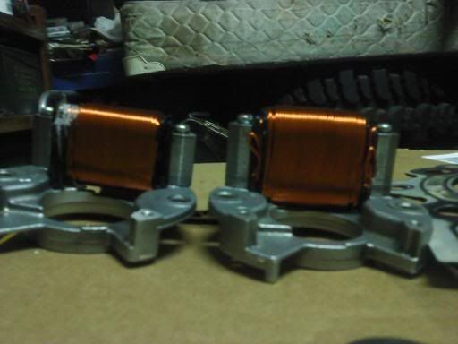

    Quick update for anyone who's interested. The stock 200x stator is nowhere near enough to reliably power a 55w HID. From what I've found out the stock stator goes from something like 15w - maybe 60watts. Even with the battery and regulator/rectifier, the stator just can't keep up. You would have to pretty much be on the throttle ALL the time.
    Anyways, ricky stator sells and upgraded stator which puts out more at idle and max, but my buddy decided to just try to rewind some himself. First one he used 18G wire and wrapped it to about the same level as stock. At idle it's noticeably brighter and when you give it gas, WOW, it's like a 350x, and that's with the stock bulbs. We haven't taken any measurements yet, but I'm sure that will be enough for 1, 55W HID. He just finished rewinding a second one, it's a beast compared to the stock. He added some of the little metal shims on the 2 ends of the stator, and ended up adding over 5 feet of additional wire. Had to do some dremel work in the cover to get it to fit. Will test later. Also wondering what 16G wire will do.[IMG][/IMG]
