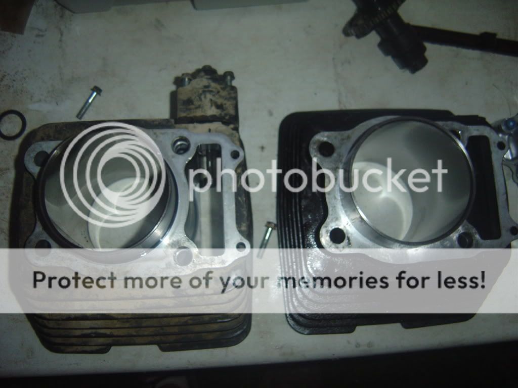

    As alot of you already know I was I believe the 3rd person to actually get my hand's on the new kit's that Corey Sprock put out for the 350X which is now said to be @ 403cc .After being asked alot of question's I thought I would do a write-up on the mod but I wanted to get a little bit of time on it until I had something to imformatively say.Now to make sure all is clear and understood here and what I state in this tread is all " My honest opinion and I am just stating my 2 cent's",I think that everybody who know's me would say I'm straight up,and I say what I'm thinking.. So with that being said here we go.
    History:
    I orginally first took out the 1st proto-type at Galamis this past winter that was built by Corey Sprock and owned by ATC-Eric.The chasis was an stock '86 350X with still running everything still stock meaning sprocket's,carb,head,ehaust,airbox,axle, etc I believe but I may be wrong,the only thing I knew that was changed were the rear paddle tire's.Also I'd like to add that alot of other's had time too ride the machine also but my 1st impression's were that it was an absolute tractor,meaning it pulled really hard and was easily climbing dune's and whatever else was thrown at it.I was impressed with what the motor was offering but also at the same time,she was a bear too start and seemed to get hot.Granted Eric did not have the decompression cable hooked up to the machine,which was my fault because I brought the wrong cable out to the dune's and the machine was barely shut off since everyone was taking spin's on it.I told myself that I had too have one of these kit's so I ordered one up and hooked the guy's up with a core cylinder too do up for me.

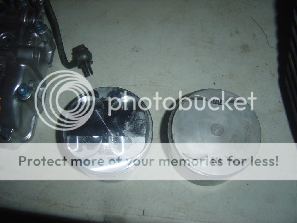

    I started this thread because alot of people over the past couple week's have been asking me my thought's on the Big Bore and I know alot more of ya's have question's also that I have'nt talked too.I personally think that for a simple bolt on kit which included a resleeved 350X cylinder and a very impressive CP piston with gasket's I made a very good investment.I obviously feel that I have a way's to go to get this engine dialed in to where I'm gonna be 100% in love with it but I also know that I have alot of option's now that I did'nt have before and all relatively simple and cheap.I don't have all the answer's as far as spec's go,you can ask ATC Eric or Corey Sprock about them but I do know that the bore is stock at 80mm and I am now at 88mm .I exchanged my stock 350X cylinder to get the 88mm ,I also recieved a CP piston with base and head gasket.The rest of the add-on's were installed by me and were not included in there kit.(NOTE: My stock 80mm cylinder is in Left of pictiure below,88mm Sprock Big Bore Right)

    Do they rev quicker with that lighter piston in them?
    I did'nt really notice anything huge as far as throttle response with my particular set-up with the 450R pipe and having the gut's still in there as far as revving Mosh,but I could absolutely tell the difference when I took the screen outta the 450R exhaust but I think with running a DG or Cobra I'd notice a HUGE differance .IMO that stock 450R pipe is just way to restrictive..I don't have any vid Shady.
