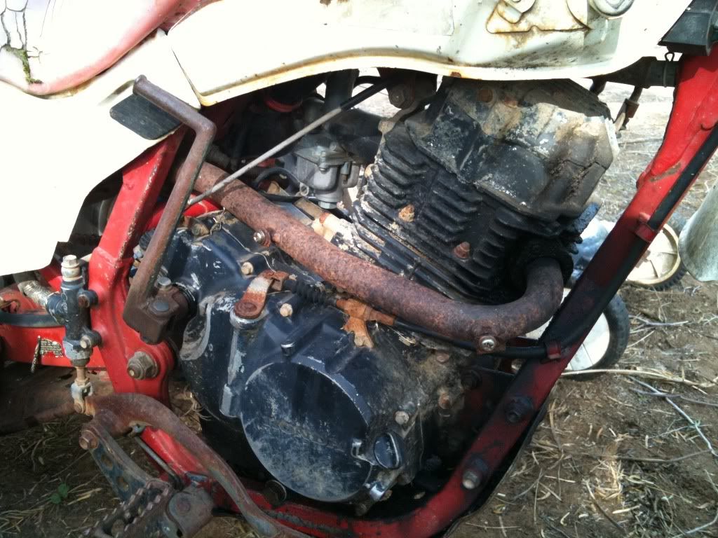

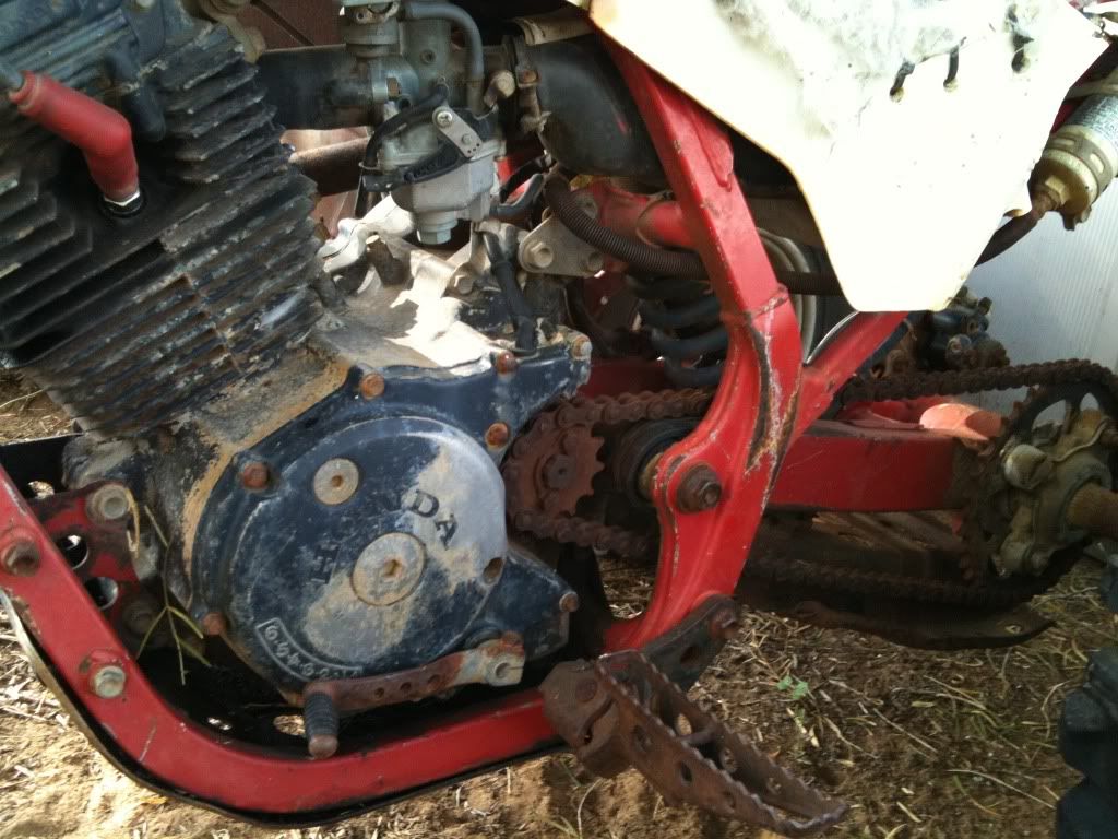

    this thing had been ridden alot and frequently it seems. still has the ignition switch and key but its not hooked up and its pretty ragged. like the rest of the bike. bent forks, dry rubber, no brakes and it smokes like a chimney.
    along with an assortment of poor/lack of maintenance. all bearings were siezed and seals just chewed apart. again.... what was i thinking.
    rode the hell out of it for a week or so and ran like hell with no compression, cant wait to get some rings in it.

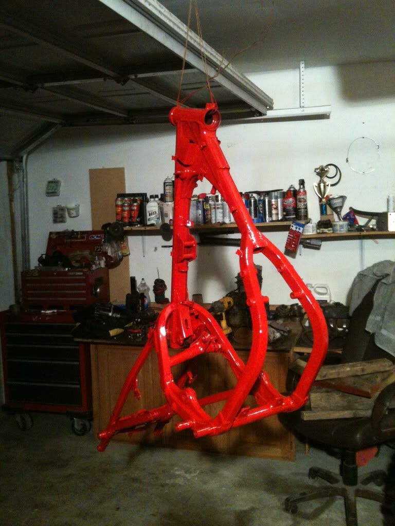

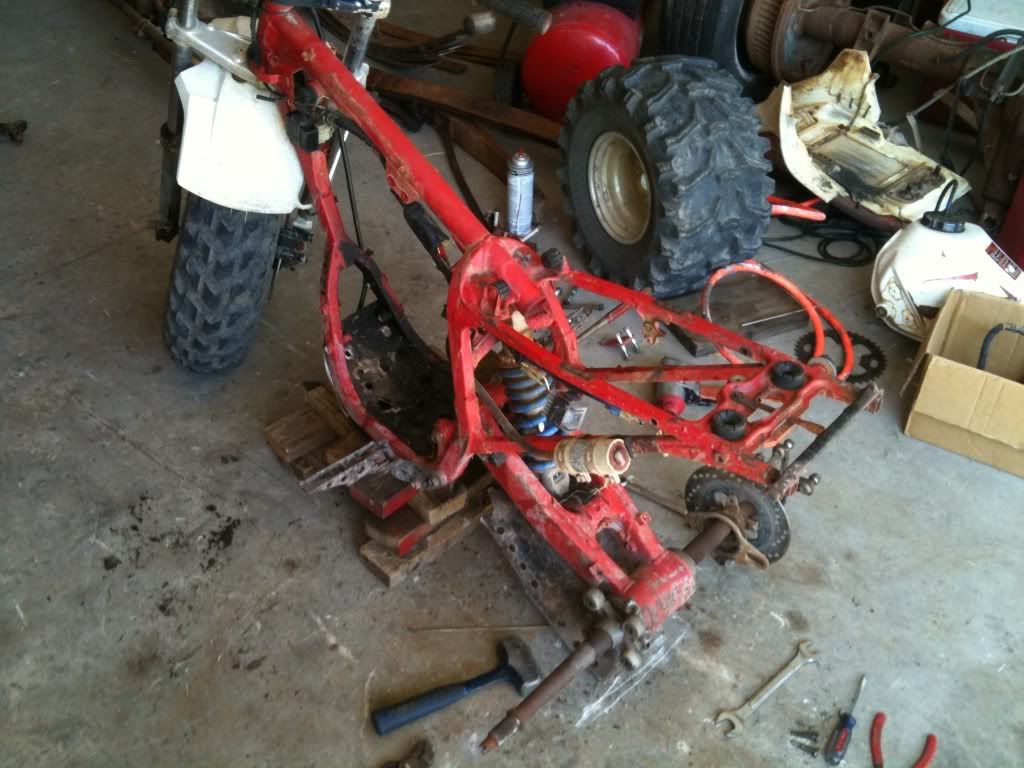

    within no time it looked like this
    couldnt get the rear axle out of the swingarm, tried it all. ended up taking the rear axle to a shop press to get the hub off the right side. no dice. ended up having to cut the off. purists, no fear, the axle was junk anyways.
    a 1985 200x rear axle was the solution, that will be here the 19th. more info on that when it gets here and in.

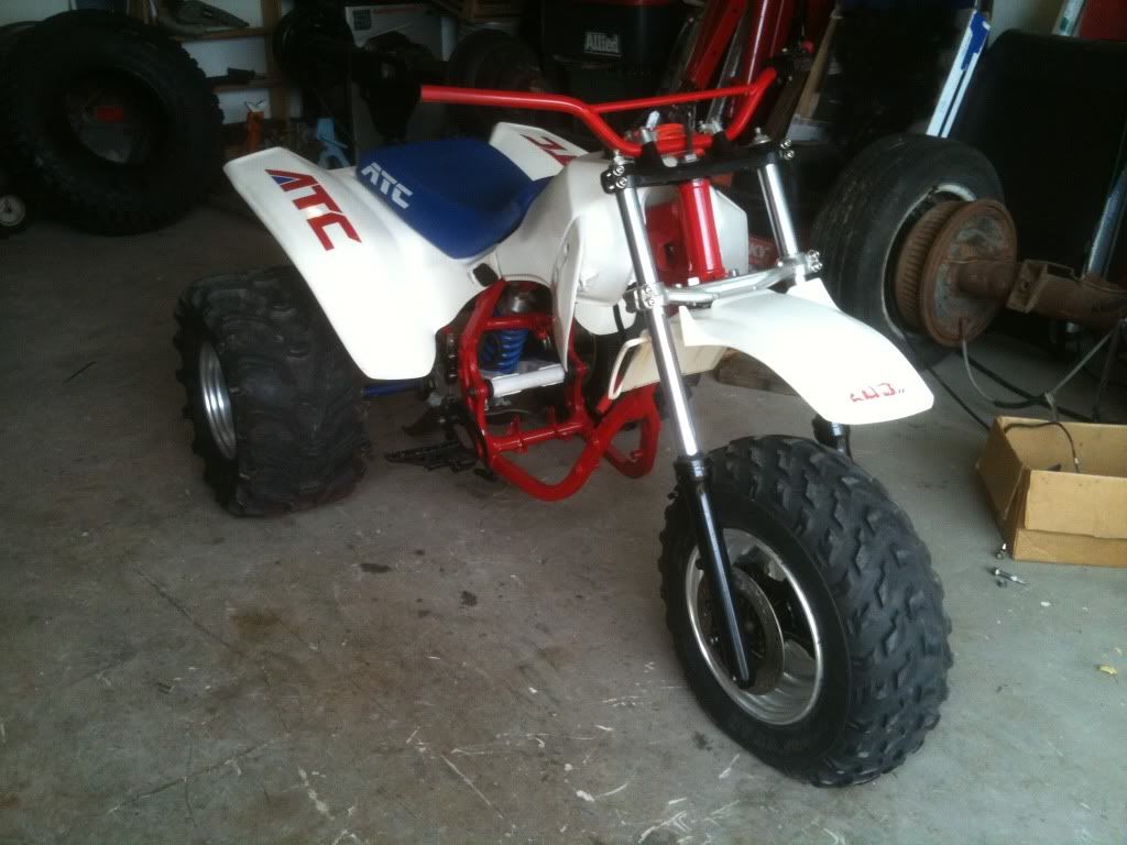

    that next night:

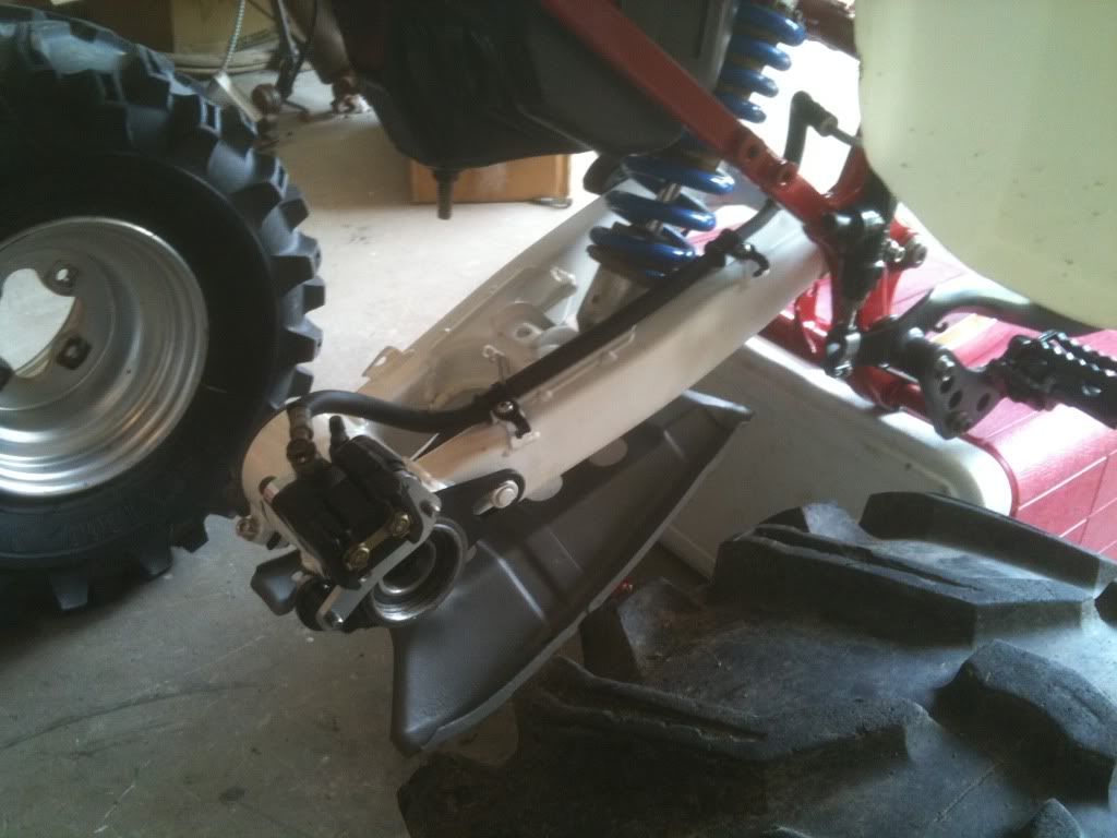

    sweet new brake parts that arent even close.
    this caliper, doesnt fit. modified the caliper bracket with the grinder, and drill.
    http://cgi.ebay.com/ebaymotors/ws/eB...K%3AMEWNX%3AIT
    it fits now that theres no rotor in, but well see.

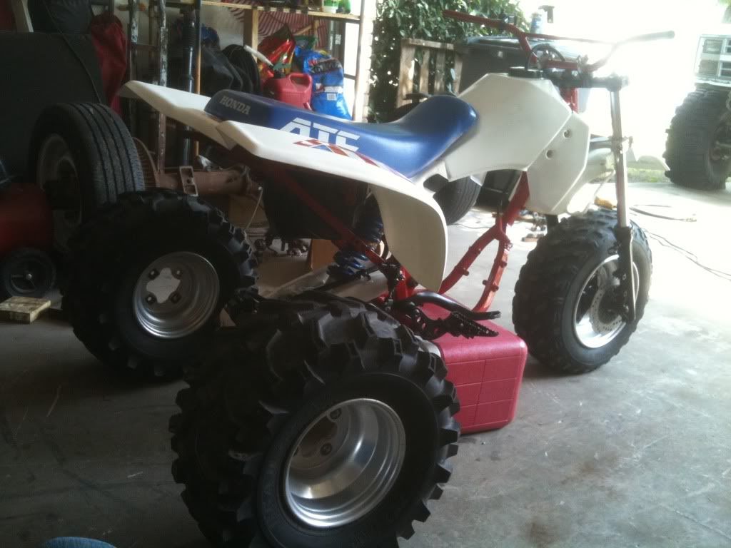

    That looks awesome. I like the red handle bars and white swing, was the swing arm on the 86/87 200x red from the factory?

    thanks man, the swinger was red factory. ive just got a thing for white.
    and funds? lol i have tried to rehabilitate everything and rebuild. and the seat actually came with the trike when i bought it! i dont believe in new parts when i dont have to. little elbow grease, paint, and polish will go a little ways. i did buy the good paint though haha!

    that 200 is looking sick. i am diggin the white swinger and red frame. can't wait to see this one done. what brand/color red is that? is the front tire on right?

    thanks, i like the white but didnt want to get crazy. the red is rustoleum sunrise red. and the wheel is on right, just the tire is on backwards.

    Dude i got that same caliper and i was pissed to when it didnt fit, i just bolted in the mount from my old rear caliper!
    83 suzuki alt125-sold
    86 350x-current-traded
    85 200x Current trike-sold
    85 200x-new trike
    83 atc 70/lifan 138
    99 cr80
    obijuan's Avatar
    obijuan is offline At The Back Of The Pack Arm chair racerFirst time rider
    san antonio texas
    226
    thats why i bought the damn new caliper, my bracket was all wallered out and danglin off practically.

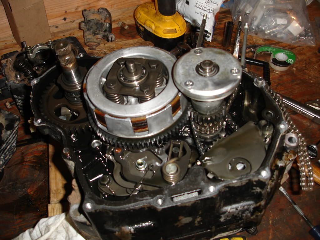

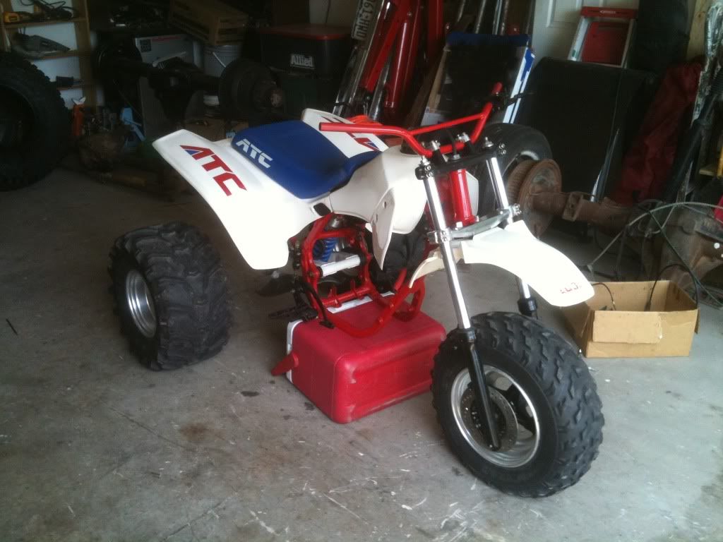

    sooo i stuck my floor jack handle in the rear carrier to get a feel for the new rear axle width, i am pleased. pretty close under the fenders but slightly wider.
    i got a little carried away tonight, dont know what im doing. gotta make a trip to honda and see if they got a couple seals on the shelf, if not its ebay FTL.

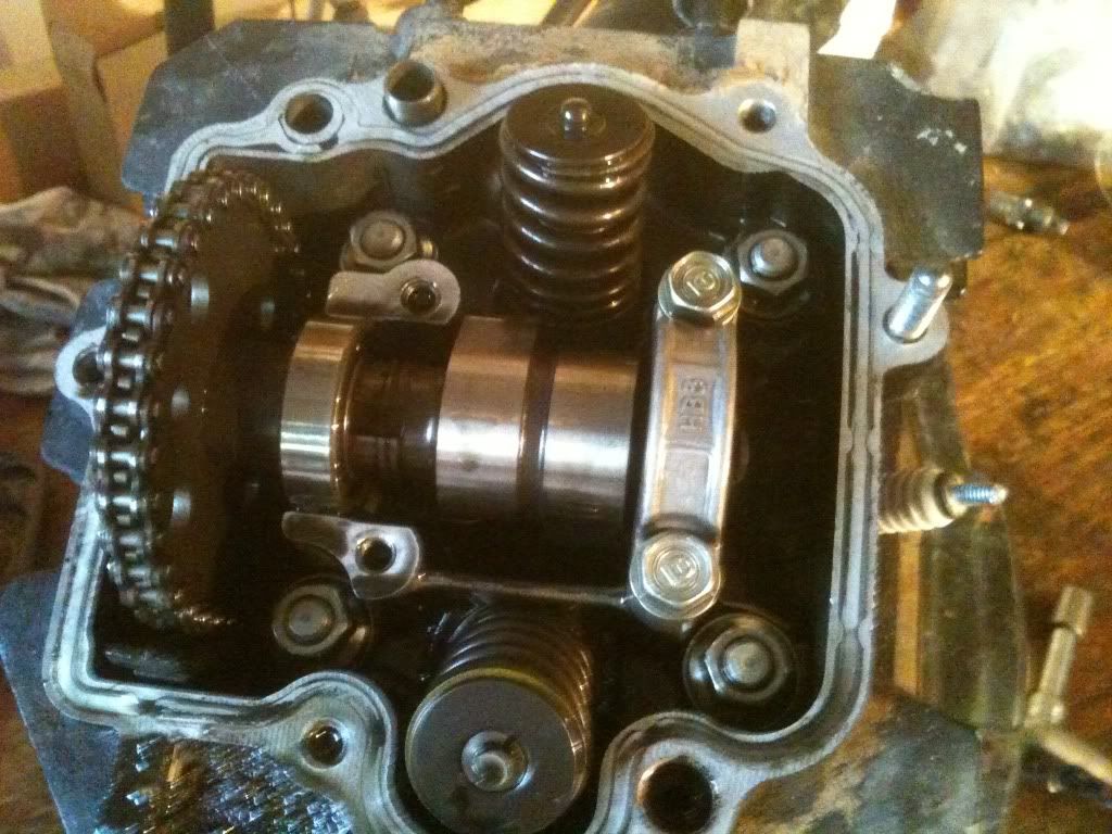

    missing something??? lol wth was the previous owner thinking?

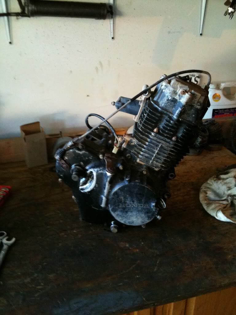

    dropped a head stud nut allllllll the way in the bottom. also noticed the oil drain plug is stripped out, so much to where i can just pull it out with my fingers.
    good thing though, the motor is pretty clean overall.
