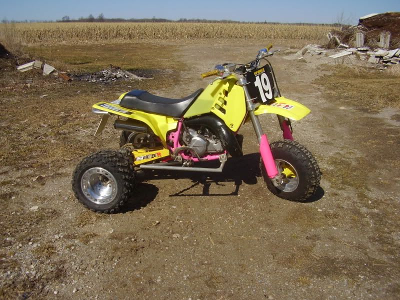

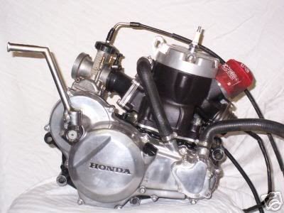

    I run a 02 model 265 PV motor in my race trike. I Friggin LOVE the thing, then again I got a +4 stroker under it, with some radical porting, small dome and all the goodies.
    It RUNS, then again Jason Hall built it!

    Ontario, CANADA
    4,538
    BUT, IT is one hella tight fit!
    im talking, JUST enough room to clear the plug cap. And I also had to dent my PT high rev pipe a smidge to make it work.
    Hardest part is probably getting the rad hoses to work around that big bulky top end and valve setup.
    You can make it all work, just takes some cursing.

    RUN IT! you will NOT be dissapointed, my 265 tears it up
    Only imagine what a 305 would shread!
    btw duncan has nice big write ups on these cylinders on there homepage.
    I am running water wetter, BR10ES plug, cool head and 116 race fuel. Takes awhile to warm up, but when it does. GIGGITY!
