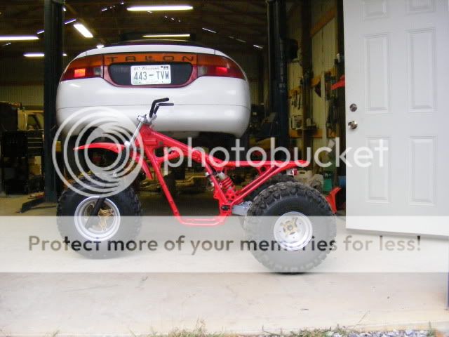

    After seeing Dirtcrashers thread yesterday and being guilty of the latest R fender on an X, I thought I would at least avoid the third strike of not posting a resolve. I decided to but the R fender Orangecnty250r had listed. It came in today and I put it on. Fit's prefect and I like it.
    Quote Originally Posted by dksix View Post
    I haven't gotten mine yet. I'll let you know when I get it on.
    There is a molded hook in the left side, I assume that's to work with some OEM 250R brake line clamp but mine is set up SWB and my brakes will be on the other side. I guess I'll make some kind of clamp that goes on the back of the lower triple clamp. I'll figure something out when I get to that part and I'm sure there will be pictures in my build thread. Here's one where you can sort of see the hook in front of the fork boot.
