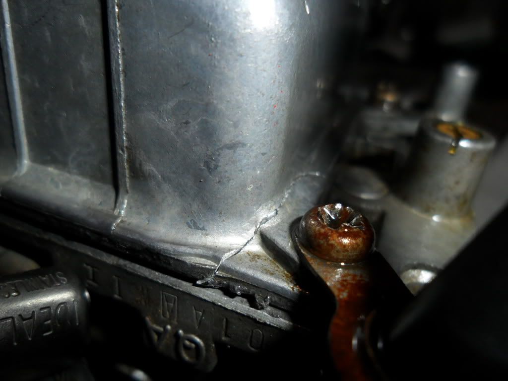

    Just pulled the carb again. Float bowl is cracked pretty good on one corner. $#*$)*&%&^$%# Any one got a float bowl for cheap? '85 250es. Guess this will slow me down figurin out why I'm foulin plugs. I dunno. (*&^%#$@% pissed now. Time for a beers.

    If I were you, and you're already planning on replacing the bowl, Why not give it a slight application of JB weld along the outside? If you get it near the gasket area you could probably sand it off. Better yet, Place a thin strip of tape over where the gasket goes and then JB weld it.

    I wouldnt JB weld it...JB sucks. Or use RTV. It swells when you get fuel on it and can make a real mess. I had the same problem with a rebuild kit on my 85 ES. Where did you buy it? Dennis Kirk???

    Bought it from effing dennis kirk. Last time. Bowl gasket/oring seemed a tad too big, but I tried it anyways. If I JB welded it I don't think it would handle the force when u screw it down tight to hold much past the cracks. Really have to figure this carb out soon, hunting's right around the corner.

    i am sure someone will be able to hook you up with a new bowl on here.where that crack is i would trust a home fix on that.get a real rebuild kit for your carb while it is out of commission

    anyway, I got a kit for 20bucks from the local triumph dealer...SHINDY also do the oem stuff so they are perfect. fit.
    ssssed off, I made a paper gasket and it still works (other carb)..thicker gasket paper may even compensate for your missing corner piece.
    rtv will melt and bubble with gas..easy to test..let some dry in a bottle cap and hit it with aa few drops of gas the next day

    my local hardware store has allen screws that fit the float bowls just fyi..maybe one of those with some custom bent washer will hold it
    oh, some carbs actually have snap wires holding the float bowl on..maybe you can make one out of an old mason canning jar or grolsch bottle.
    with a longer screw or 2 , you could even make a bale wire so it goes diagonally over the float bowl to another screw.
    I'd be so aggravated that I'd fix the sucker even if someone handed me a nonbroken one.

    I didn't have one of these in my carb or in the rebuild kit. Could that missing be the cause of fouling plugs so quikly? I've rebuilt many carbs for wheeles and auots and never had a problen like this. I guess I'll try to 'jerry rig" the float nowl till I can come up with a replacement. Thanks, Matt.

    I JB Welded the float bowl, it seem to be holding up and not leaking. Definately a temperary fix till I can find a replacement.

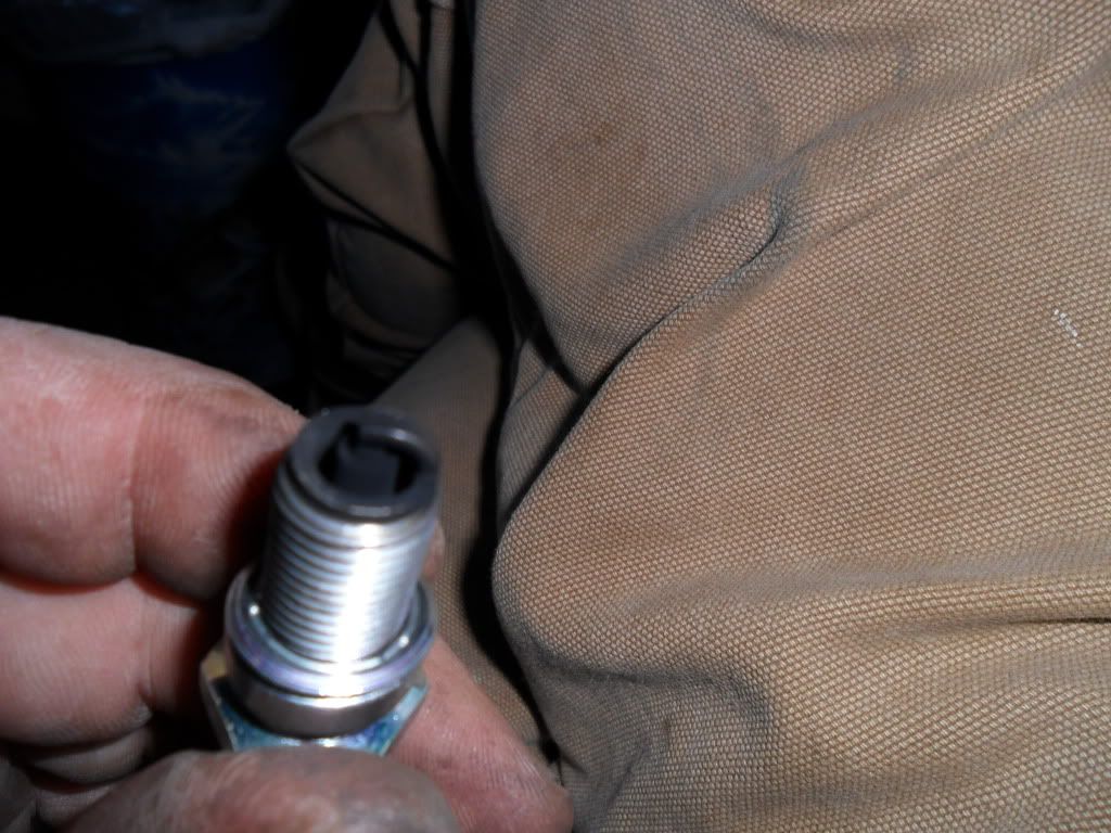

    No better. Here's a pic of a new plug with only 1 1/2 minutes runtime max.
    [IMG][/IMG]
    What to do? Could mis adjusted valves couse this? Maybe timing? Gonna go back out and check them valves, probably should do it anyways.
