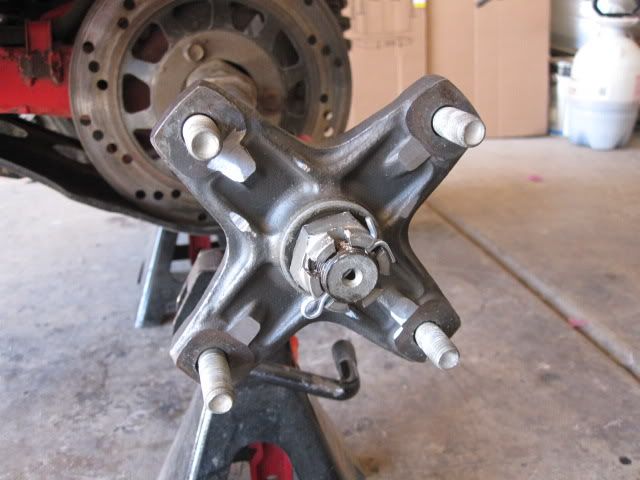

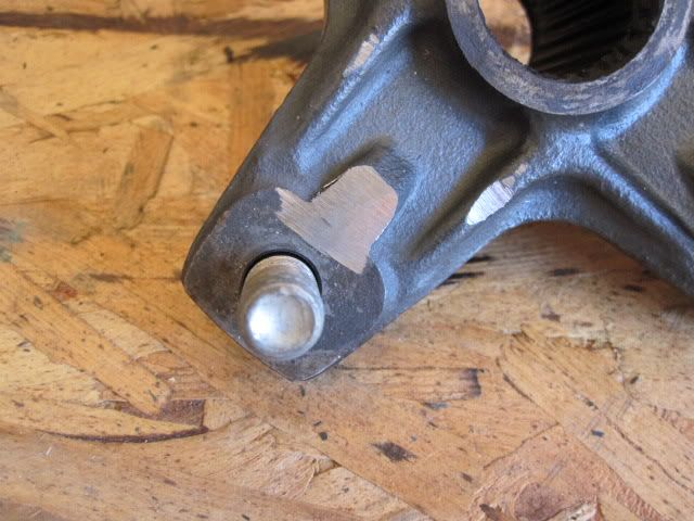

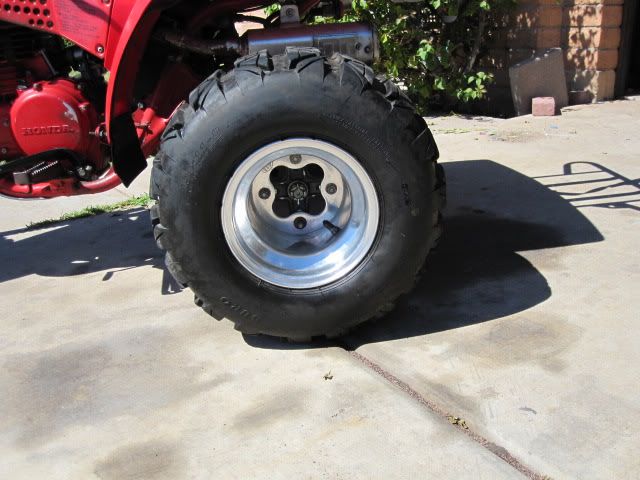

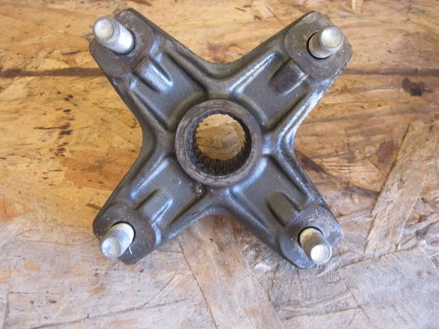

Ok I thought I'd share this....it's really no biggie, but it worked out nice and may help somebody else. I recently picked up a bike that I thought the wheels would be perfect for the 1982. The wheels are off a 1985. I had some 200x hubs that match up with the axle splines on the 82, they also match the bolt pattern on an 85 liquid. The only real mod I had to do to make the hubs work was grind away the bumps to make flat (just see pics). Anyway thanx for humoring me.
Looks much better now and should dig right in. I'm very happy with it.
