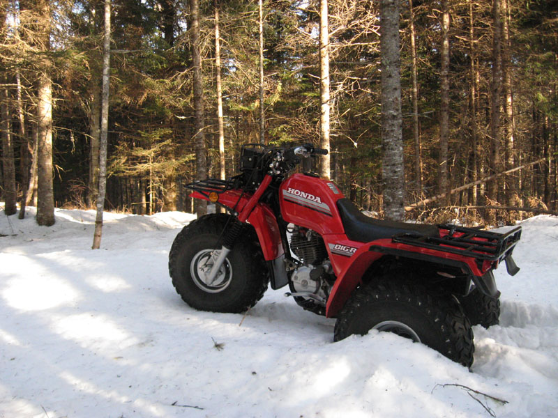

    I think it's safe to say that I do most of my riding in the winter, once the ground is well frozen and there's a good snowpack. My old Red has the original Ohtsu factory tires...but I haven't really found them all that good in the deep stuff. As long as there's a crust...it floats well...but if it breaks through...you're done.
    I'm just wondering if anyone out there can give me some tire reccomendations? Seems like all they want to sell me are the Kenda Bearclaws (sixe 25x12x9)...but I'm looking for something with more of a chevron tread pattern, and high flotation with low tire psi.
    Thanks for any info...pics to come...

    real nice bigred!! get the carlisle strykers, common tire, and good performance in mud and snow.
    thats whats on my big red and had them on my 110 for a while. heavy, bullet proof, good traction. I agree they are a good tire. but they do digg a bit if your not careful in snow or mud. no big deal
    not my first choice but a great affordable tire that will last a very long time
