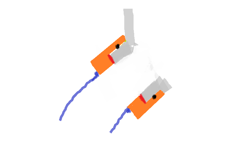

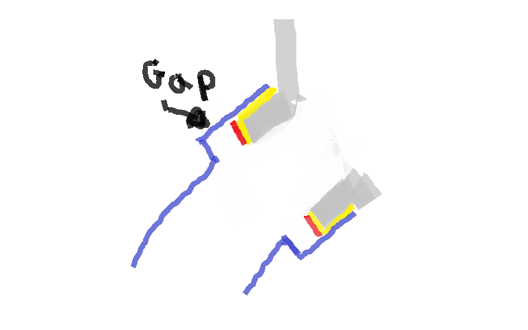

    I am about ready to cut the flange off my DG and make a new tight fitting peice with an internal groove for an o-ring. I dont like the DG Tri-z setup one bit... I have the oem gaskets, but they are a joke with this pipe... If i trimmed the flange, the header portion would hit the frame downtubes. I dont like the gap between the cylinder and header pipe. IMO it renders the gasket completely useless.. and probably disrupts exhaust flow...
    Please excuse my lack of painting skills.. lol.. red is gasket, yellow is the discontinued? gasket.. Blue is pipe header and flange... and gray is cylinder spigot..
    This is a general idea of what my new o-ring flange might look like...
