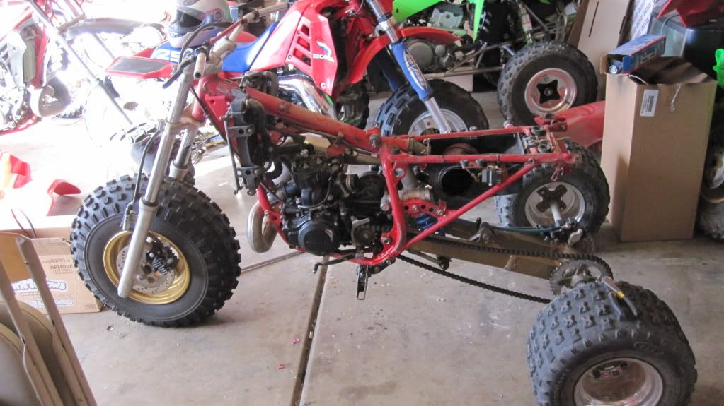

    Ok so I didn't sell the bike I had listed up. So I decided to keep it and build a dune machine. Everyone keeps telling me I need to go to the dunes....so here we go. I went and picked up a nice straight frame with a title yesterday so it will be titled now. Mostly what I'll be doing is either painting or powder coating alot of things on it. The motor top end will be pulled of and new gaskets put on if nothing is needed. Already has a homemade extended swinger. Never been to the dunes and never built a dune bike so anything you guys know I should consider while building please feel free to make suggestions. I'm in no hurry with it so it's gonna take some time. As long as she's done for Imperial invasion that's all I care about.

    Ok so k&n with a sock. As far as my other 85 I'm gonna keep that one for my desert bike. I've got plenty of time to make this reliable as it aleady runs good.

    I have to do a frame change so...if I have to do that I may as well just freshen it up. If I end up wanting to go sonner than later I'll just take one of my other bikes.

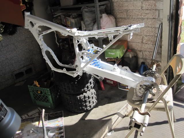

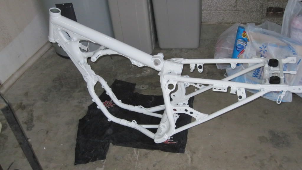

    Ok finally a little progress. Got the frame back from the painter. Looks great. Next I will be paiting the swingarm, motor and so on.

    Baby steps lol. This is far from a resto. Should look nice though when it's done. I did polish the shock canister. It's been dubbed "white lightning" by me lol.
