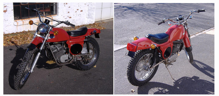

    Rattle can jobs are what you make of them. If you prep, take your time, and clear coat they can come out really good looking - and do not rub off on your clothing (although over time with use any paint will rub off, just like stuff from the factory). I Don't have any powder coating experience, so I cannot tell how they compare. But I've done many great jobs in the past. I've found with engines and pipes the bbq paint works best, even better than the PJ1 oem match stuff. Don't bother clear coating them, it seems to cause more problems than not, besides ti's easier to touch up if you don't do it. Rustoleum seems to have taken over for the duplicolor paints in stores around here,I haven't tried their color match stuff but it seems to be the same. Plasticote paints also work well, but are getting harder to find here for some reason.
    ^^Rattle can job^^
    using duplicolor paints
