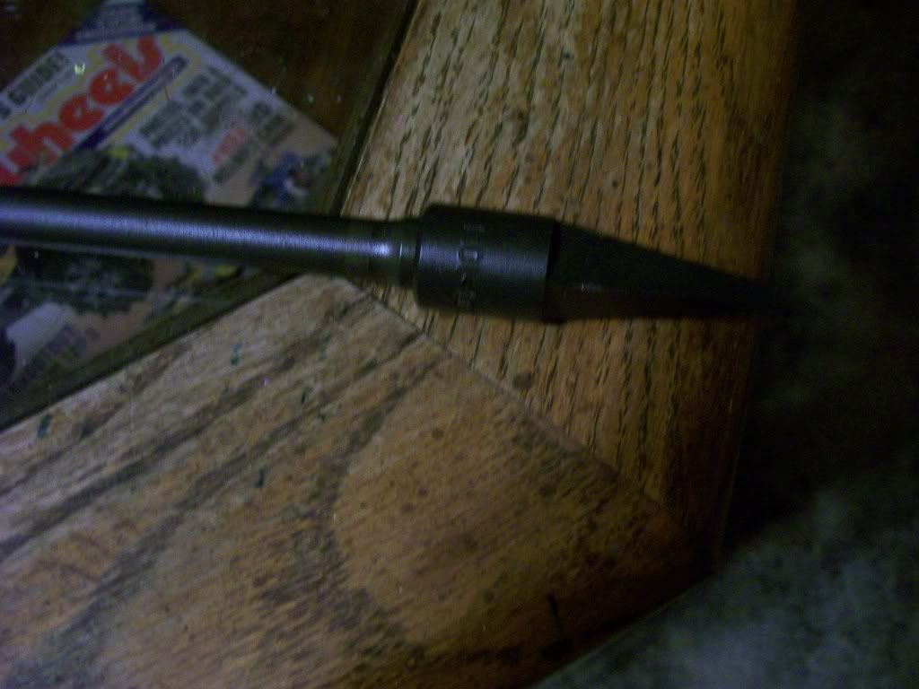

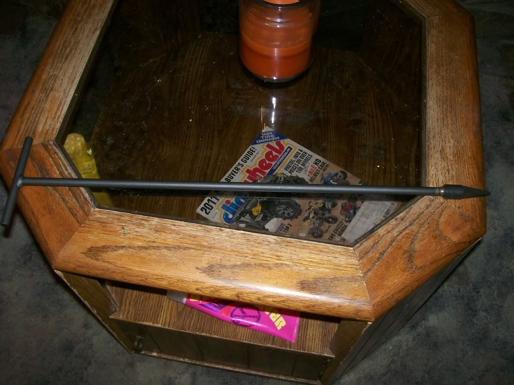

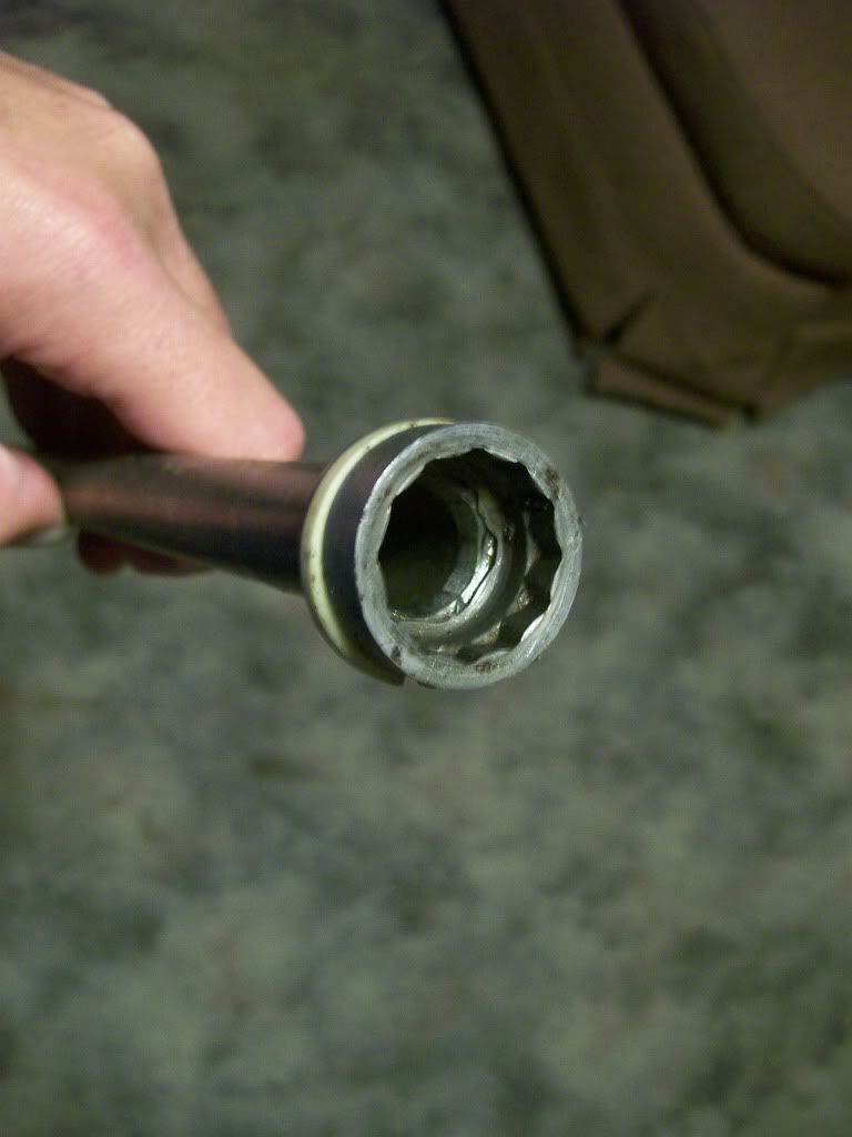

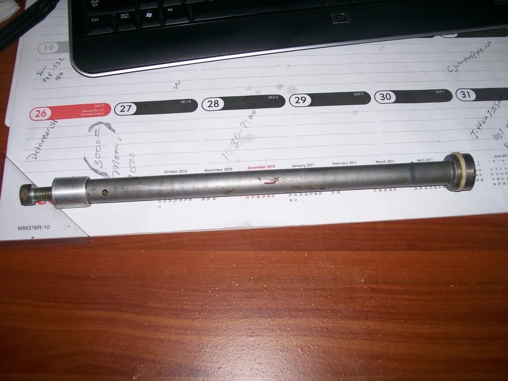

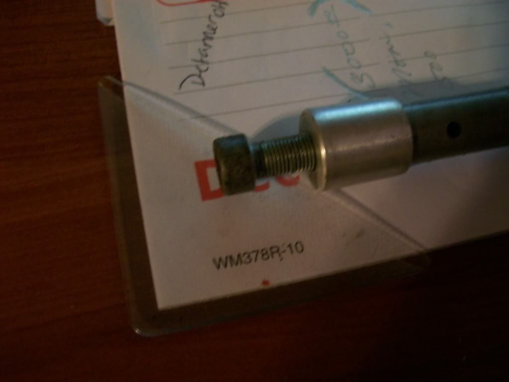

    This is the part (damping rod) that the allen bolt threads into inside the fork tube. It attaches the fork tube to the lower.
    The top of the damping rod has a 12 point like pattern inside of it. I can't remember the exact size of bolt head that fits, but it will fit into it like a socket. You weld the threaded end to a rod and put a t handle on it to keep the damping rod from spinning when you hit it with an impact.
    Or buy an $80 Kawasaki tool that works like poo. It's like a wedge you force into the head to keep it from spinning. Works, but not very well.

    I made a tool a while ago if I remember right it was an 18 mm(outside) nut that I used.
