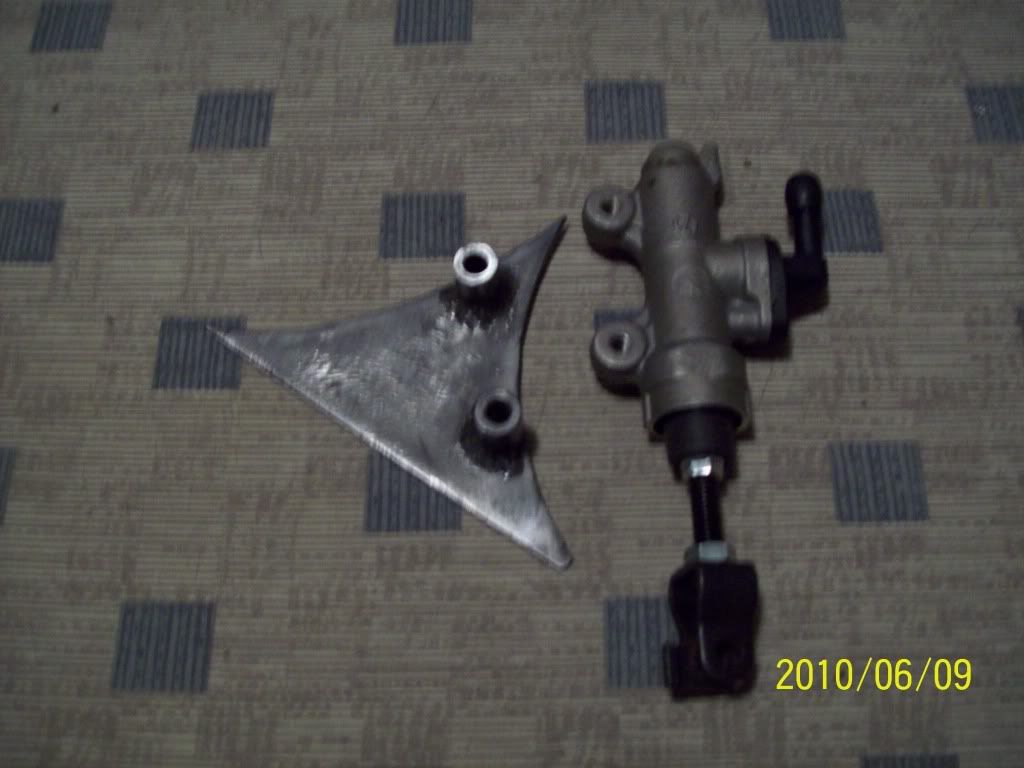

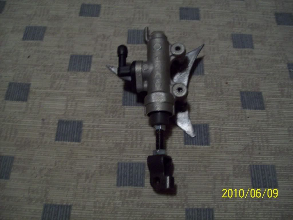

    If you guys don't like those, I have a gusset made for that lower right side that uses any 450R master, (and strengthens the frame...)
    Grind off the old, mig weld in the new and it's ready to go.
    I have pics if you want them.....
    Allot of masters will not fit, something will interfere. Thats why I made the gusset, the bolts come through the back to secure it.
    PS - A brand new 450R master is like 47$. Thats 20 years of riding for 47$...........

    The gusset has my usual curve to it and I weld 2 clear posts on it, then it's bolted from the back. Cutting down the 450R resevoir line or just running some fuel line gets the fluid there.
    I gotta see how long they take me and show you guys some pics but I have to cut them out (.125 steel), form them, lathe up the spacers and mig weld them. I'll try and do them for 40$ a pop, weld on and go............
    I'll get some pics.
