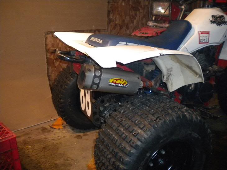

    bought a fmf megamax2 muffler from a 300ex ( just the muffler from a full system) from oldskool83, got around to installing it lastnight, very minimal work needed to get it on,
    cut stock muffler off leaking as much pipe as possible, weld on a seconding of 2-3" worth of pipe ( atleast 2'' to get muffler body to clear the frame) weld it all up and bolt the mount to the grab bar mount,
    my buddy welded it with a fluxcore wire welded, and his welding skills are lacking but it works

    looks like it worked out. good deal i still got the header lol

    lol, no use for the header unless i wanna cut and weld and make a stepped header .. its a trail machine so im not worried about the little bit of power gains from a header, i just like the deep thump it has

    looks pretty darn good. did you notice any power gains?

    Holy bubble-gum Batman! Get a grinder on those welds stat!

    tonight was the first time i got to ride it with the fmf on.. and im impressed,nice deep tone, not raspy, low ned power gallor, i was throttle wheeling 4th and 5th gears on ice tonight

    I like the way your bike is set up man, I too was thinkeing about finding a 400ex pipe or 300ex pipe and makeing it fit on my 200x. Now that ive seen someone else do it I might just do so myself

    with the exception of my buddys poor welding skills it worked out great, only had to add a 2" section of pipe to get it to sit where i wanted it and it sounds great, ill try and get a vid of it this week, i spent four and a half hours out riding the river today and the 200x only let me down once, i lost it doing a wheelie and bailed and landed knees first on rough ice, the megamax makes my little 200 sound bigger than it is, honestly i think it sounds better than the new 450s, no where the power but the sound is great
