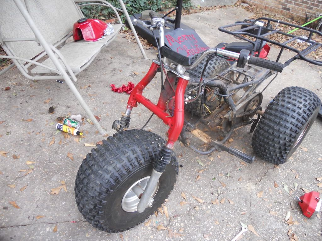

    After thinking about which direction i was going with ol' red, I decided that the only way to go was better! So, im taking my nice running and riding 1983 185s and doing the "big build", restoring everything (workbench not required). Here's what I started with:

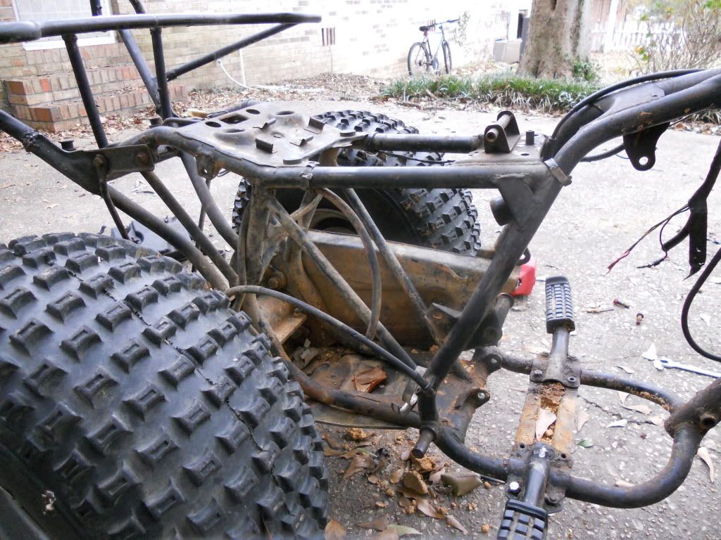

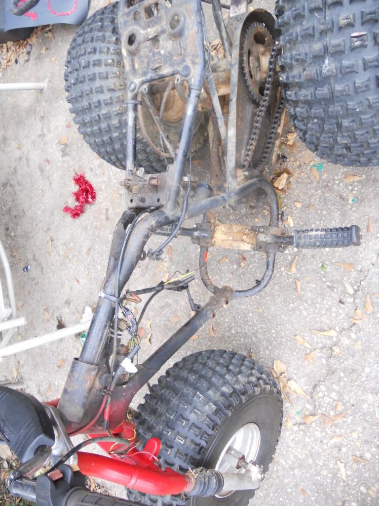

    And the teardown:
    Attachment 111359
    this was so i could remember the cable routing
    Motor, Carb, Exhaust, Airbox, Headlight, all gone

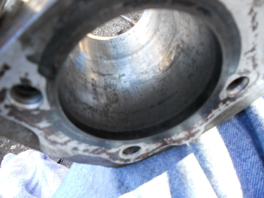

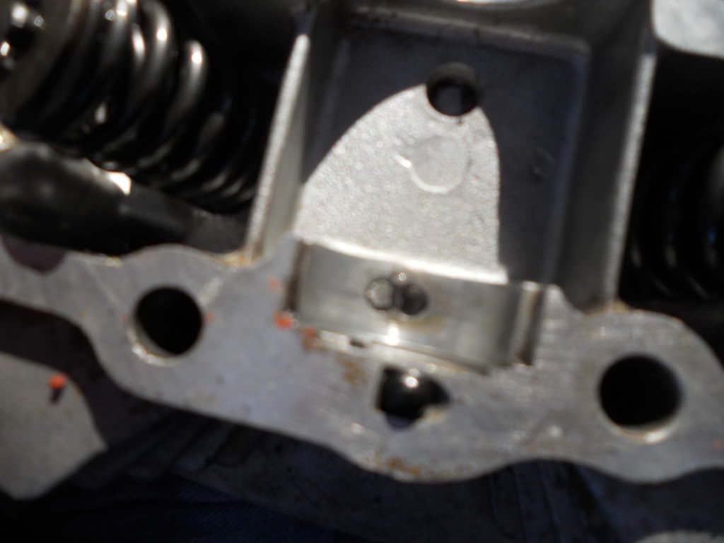

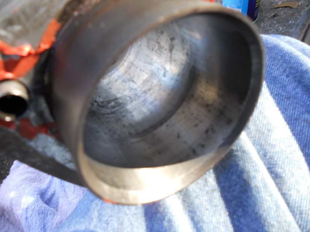

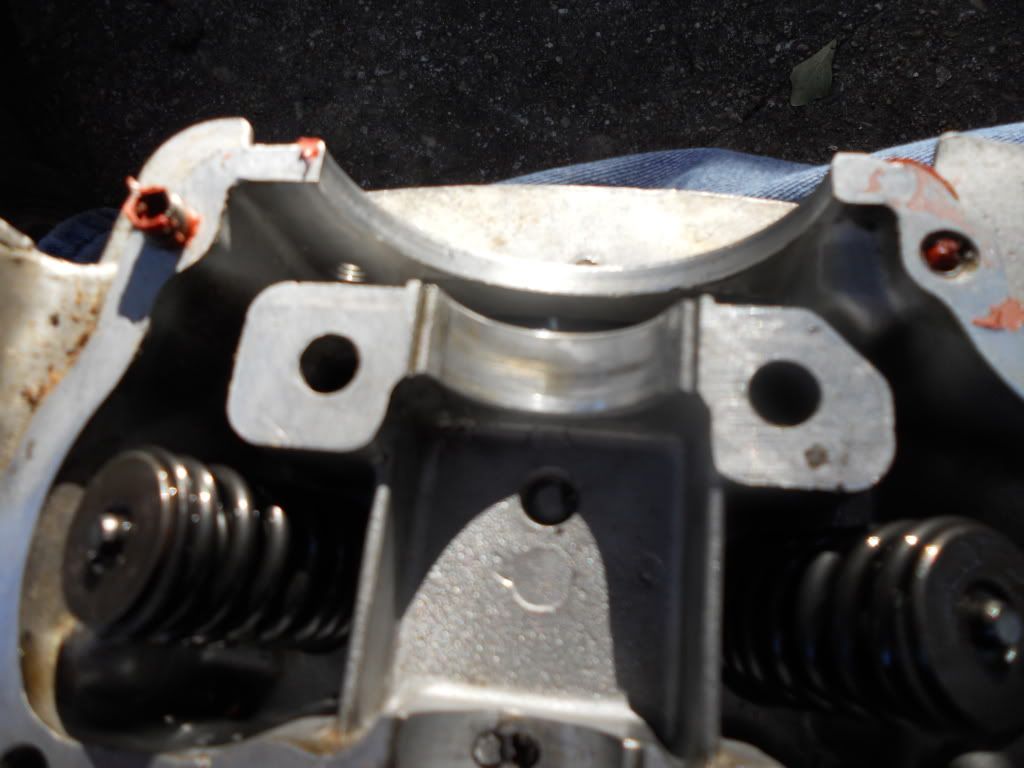

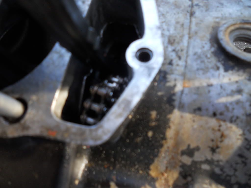

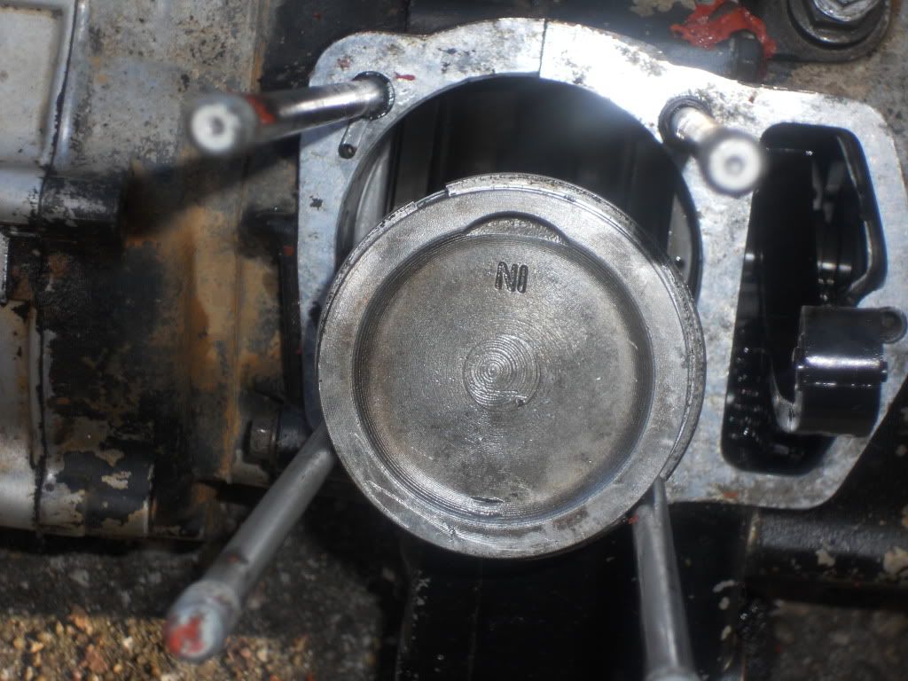

    I got up and got and got an early start on tearing down the motor for the cam chain replacement and didnt like what i found, the motor's pretty rough i think im gonna bore it out and get a new piston along with the cam chain and tensioner
    note the valve marks on the piston. Im sorta glad my camshaft was worn out
    sorry out of focus
    cylinder looks really bad
    camshaft bearings have just about had it. but not bad for 27 years i guess
    what do you call this? it doesnt look too good.

    I am planning one of these soon. Mine has a timing chain rattle in it also. But has lots of power still, so piston would seem to be ok. But If I'm that far in, might as well check it out to.

    That cylinder isn't all that bad, I've seen worse. LOL Don't forget to get a left foot peg as yours looks pretty bent. Rebuild those front forks too. Don't forget new cables, new grips all the nice little goodies.

    "cylinder looks really bad" Mine looked worse. Hone that puppy out! You may be surprised by the results.

    im going to my grandfathers to hone it out this weekend. do i need a new piston or just new rings?

    You need to hone it to the next larger piston size. So you will need a new piston and rings for that size overbore..

    how will i know the valves are ok? i see the marks, i heard the pinging, but they dont appear damaged at all...will i just have to get it together and run a compression test?
