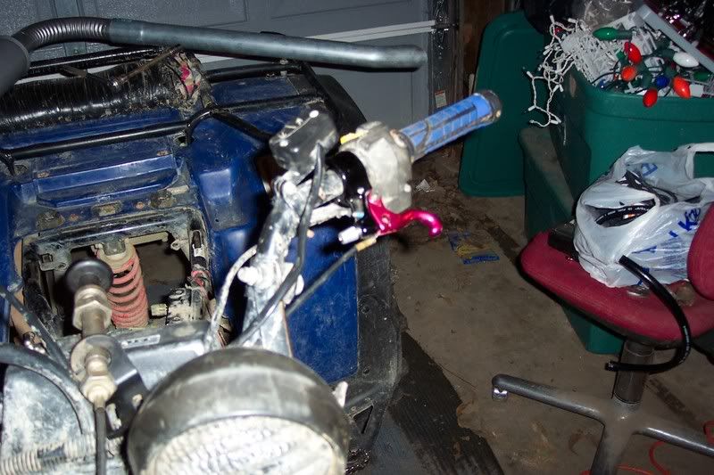

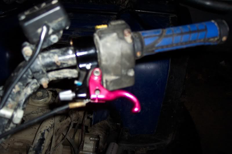

    shouldnt be hard..... i made a custom reverse lever for my trx300. rear brake cable stretched so instead of leaving it on there dragging or the lever flopping i used a bmx brake lever...... its a dia comp dirty harry flipped upside down. plus its got the "neat factor" goin for it. just gotta inform ppl its not a brake before they ride it. used stock cable and had to cut the barrel piece off of the adjuster and thread it into the lever, then go in fron the back side and adjust the slack
