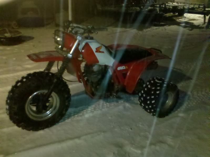

    heres mine with a set of 18x11 fast trackers, on a set of +1" offset rims. if u do the math i'd have to go up 2 teeth on the front to make it equal to having 22's. but i only went up 1 tooth. it did lose alittle top speed, but it accelerates faster and handles better. if u want both more top speed n more accel, u need more horse power
