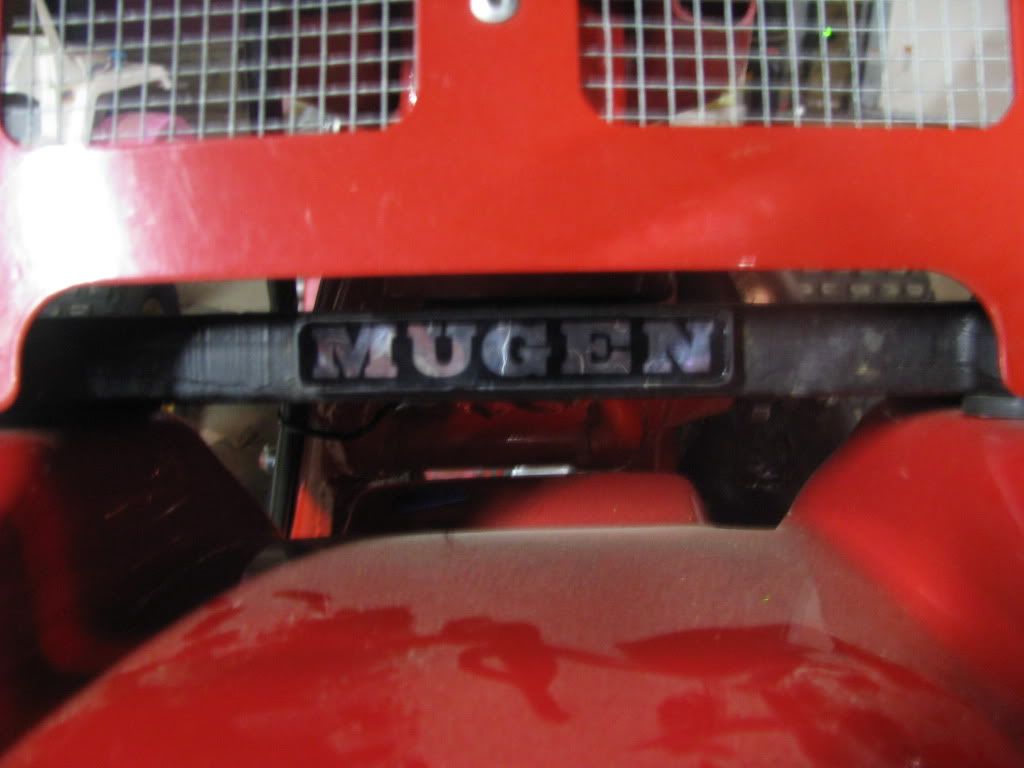

    I'm going to take the honda the tripples and put a mugen sticker on it

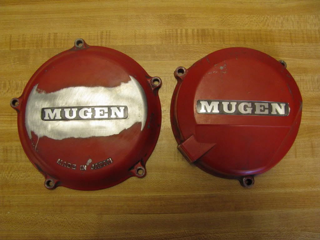

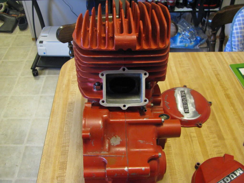

    Here's where they machined off the honda for the Mugen sticker. They recessed it a little to protect the sticker from a boot.

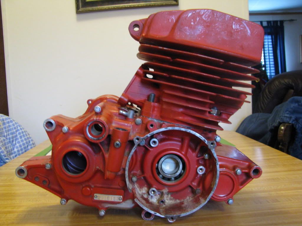

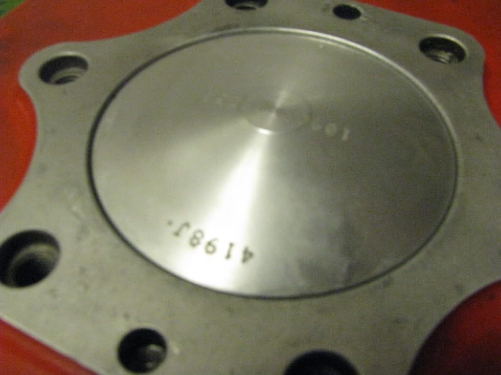

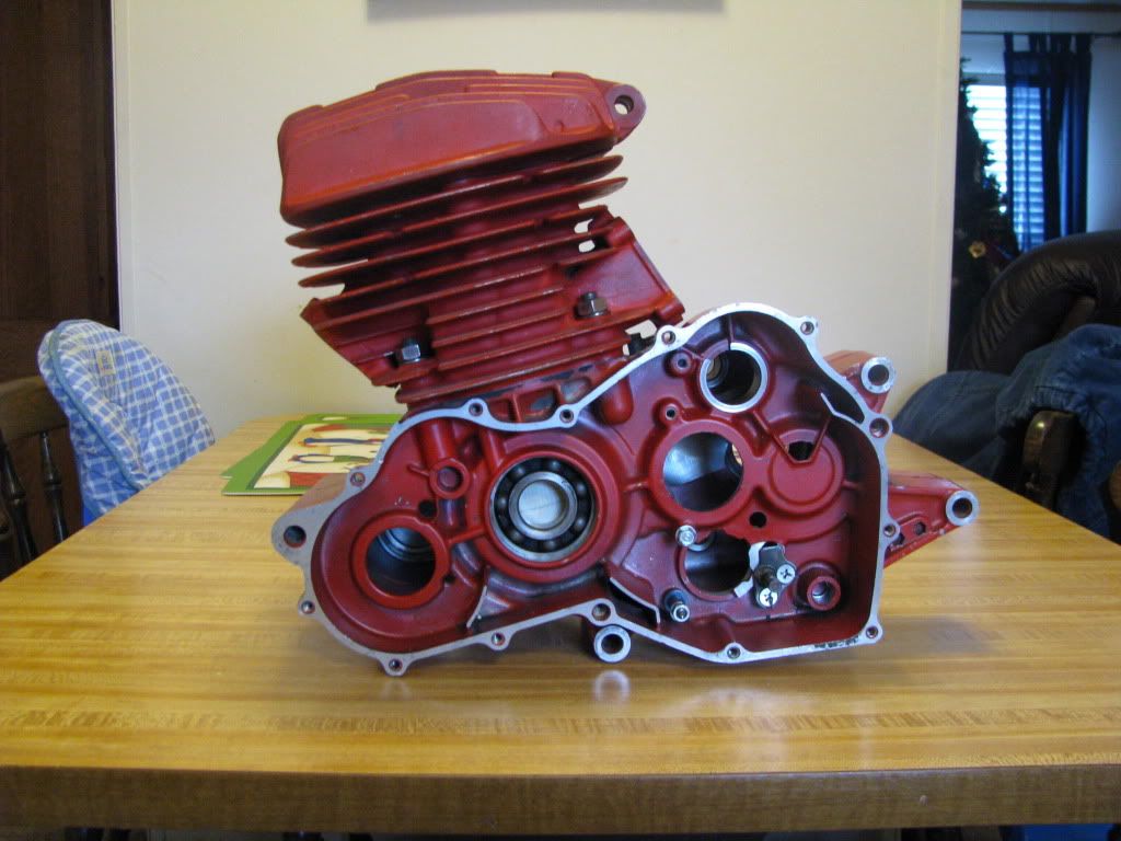

    Here's some pictures of the motor mocked up

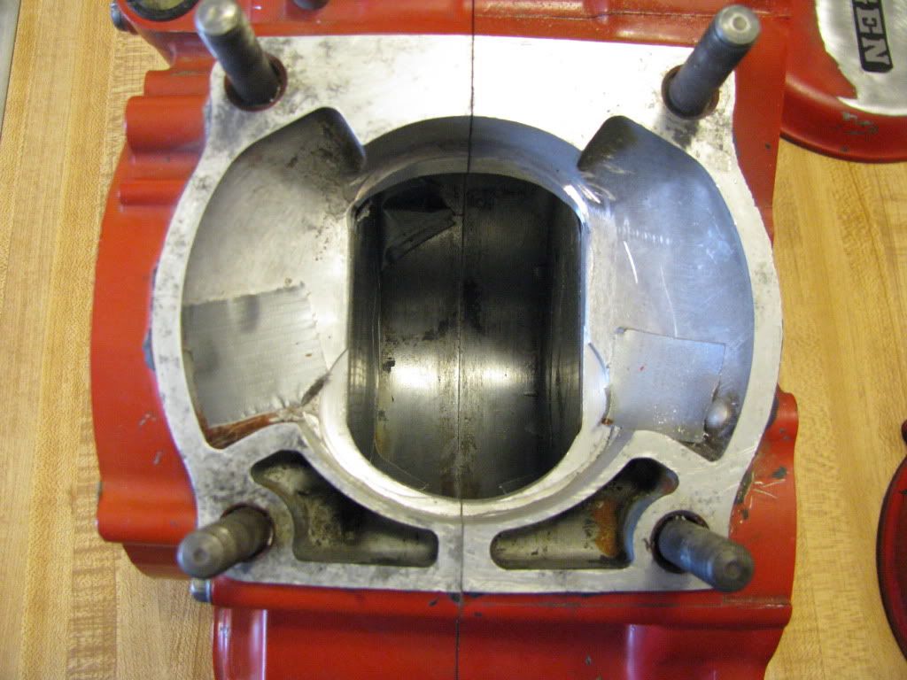

    The cases had to be bored to make room for the 83.5mm bore

    Looks sweet!!....whats that piston out of...??? looks like a Wiseco..
    1985 Tri-Z-
    Kentucky
    511
    Quote Originally Posted by MTS View Post
    Yea, It's a custom made Mugen ME360 Wiseco piston. It measures 83.5mm where a stock is only 70mm.

    Got my motor back from Flotek the other day. The piston wasn't uncovering the ports all the way and was coming up short of the deck so I decided to go with a stroker crank (69mm instead of the stock 64.4mm) to fix the problem. It's going to be 373.33cc now with the stroker crank. Flotek ported it and got the squish figured where I just have to put it together. I' m going to send the cylinder and piston off to US Chrome to do the nicasil plating and the are going to coat the piston with that anti friction stuff. Big Bore is making on of his hubs like he used on his 480 so I can use 200x forks and brakes and still keep the wide front end of the 1st gen 250r. I will be running 10" Douglas wheels to clear the brakes. I've been getting a pile of parts ready to go to the powder coater. I'm going to try to get every part powder coated at one time unlike the last build where I made several trips back and forth to the powder coater. It slow going but I want to take my time on this one.
