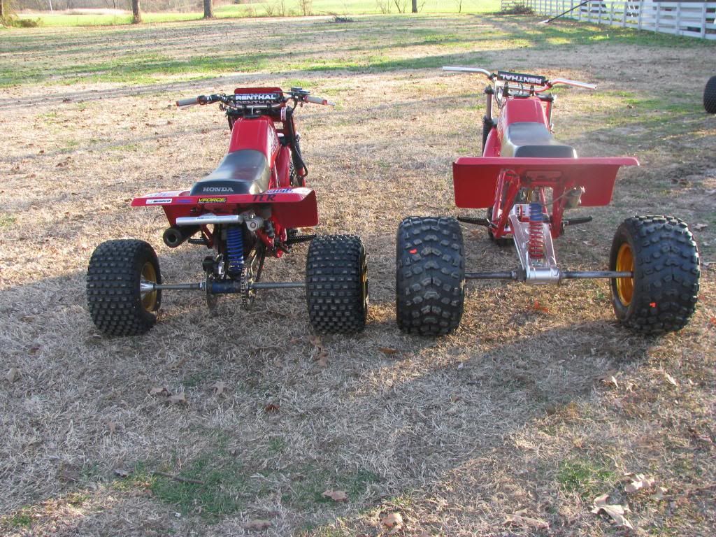

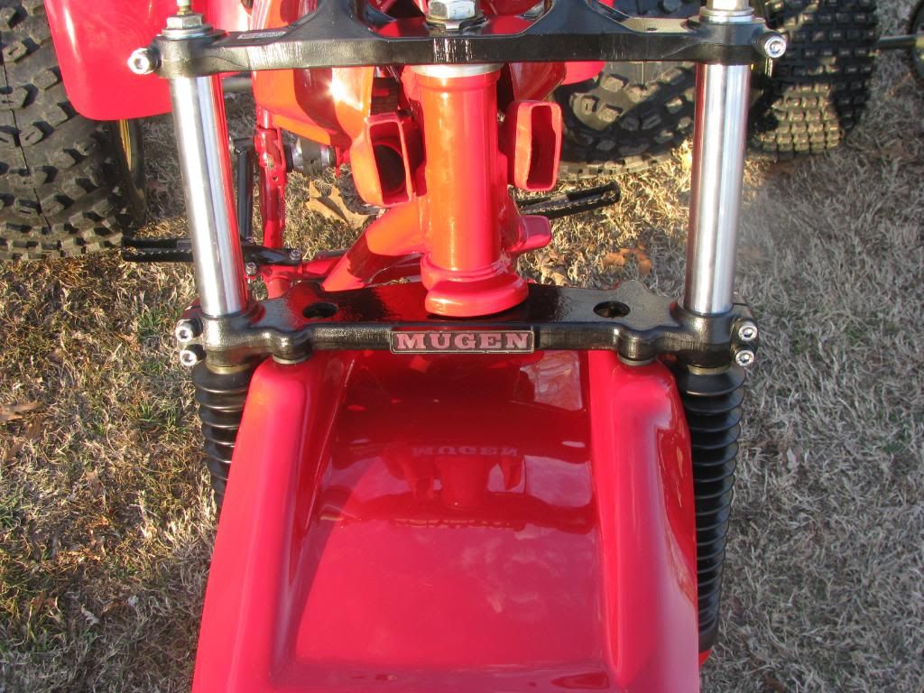

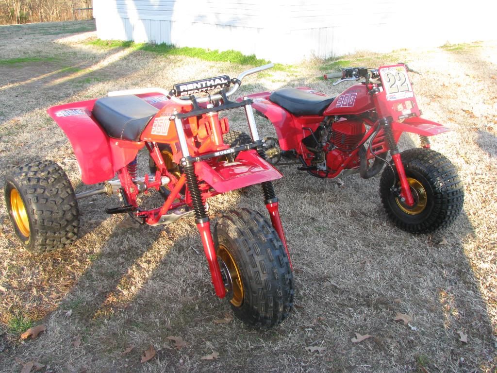

    Got to get the 300r out to compare it with the mugen 360. Two different schools of thought.

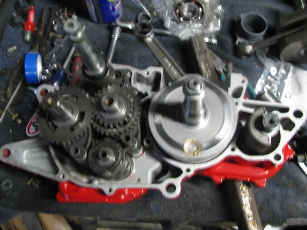

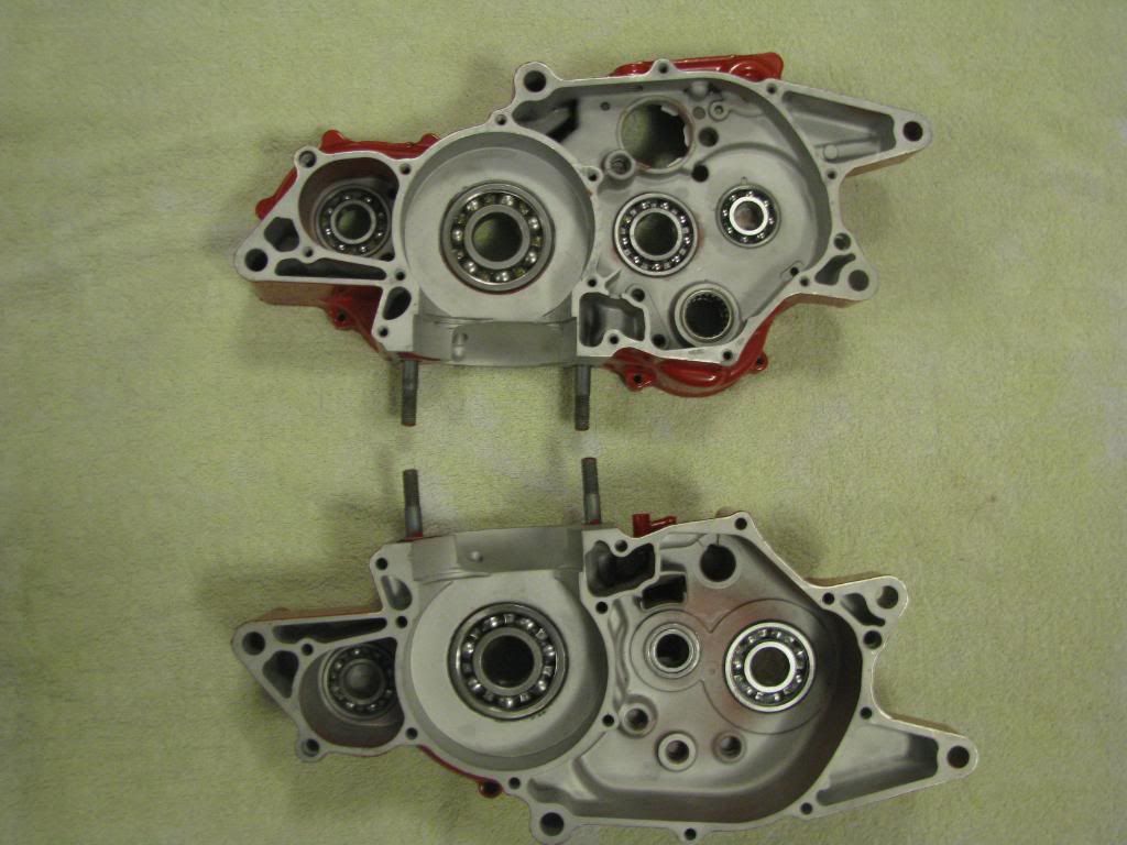

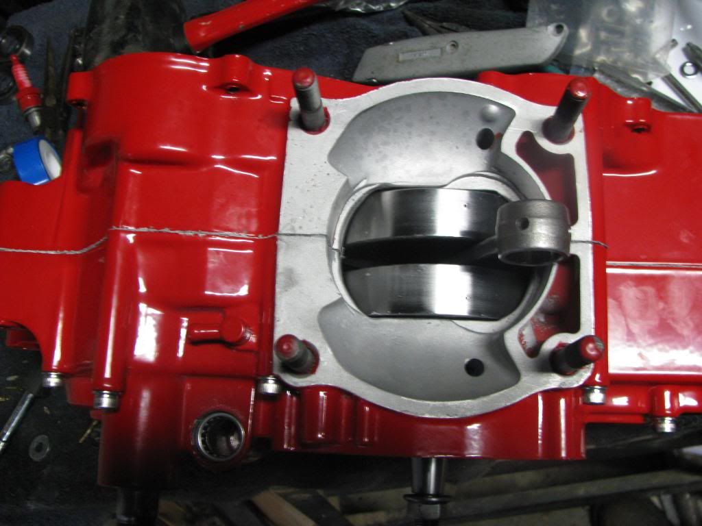

    Working on the engine today. I'm getting everything clean and ready for assembly. Installed the bearings in the cases and waiting on them to cool down. I've been putting it off for long enough. Might have the bottom end done by tonight.
  4. #64
    Kentucky
    511

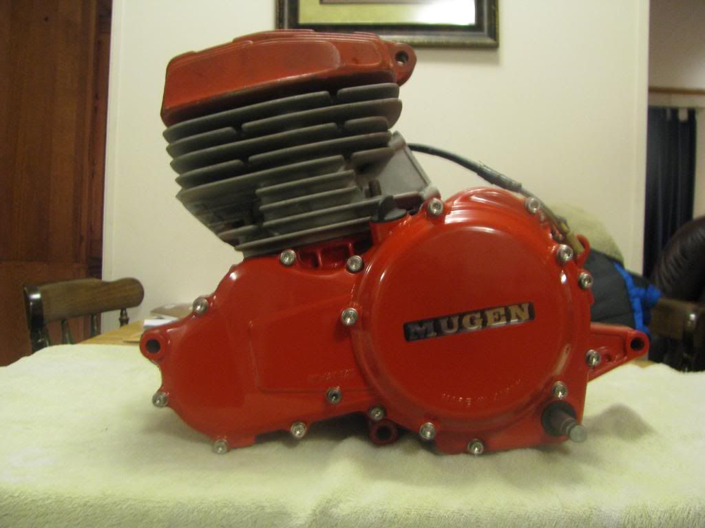

    I got the bottom end done today. I slapped the top end on temperary to do some test fitting in the frame next weekend.

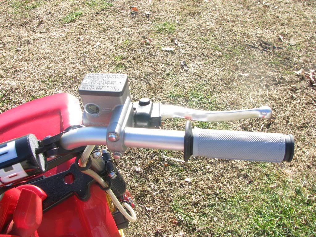

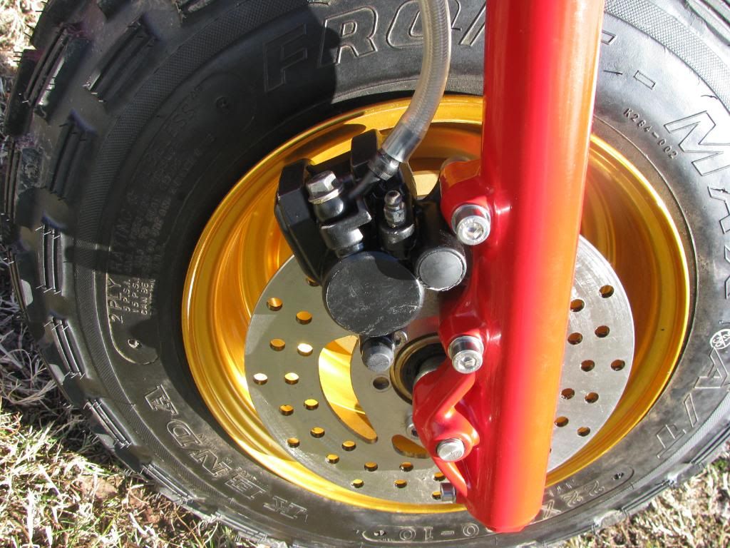

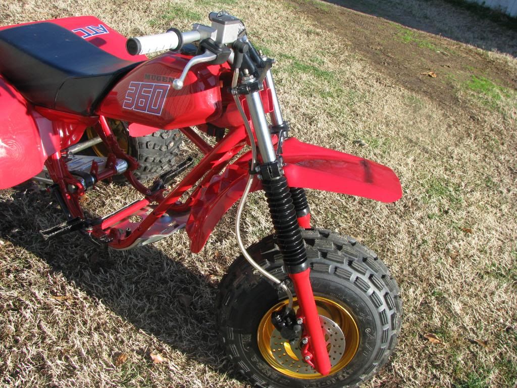

    Got the calipers rebuilt and test fit the new braided line on the front. It worked out good. Here's some pics.

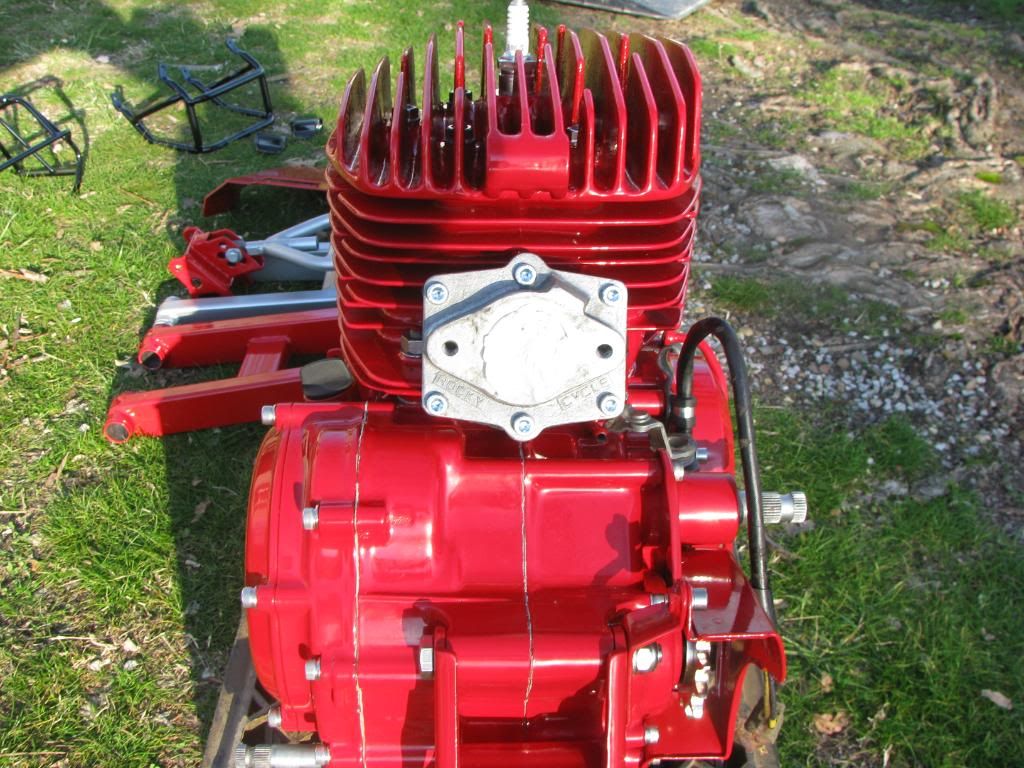

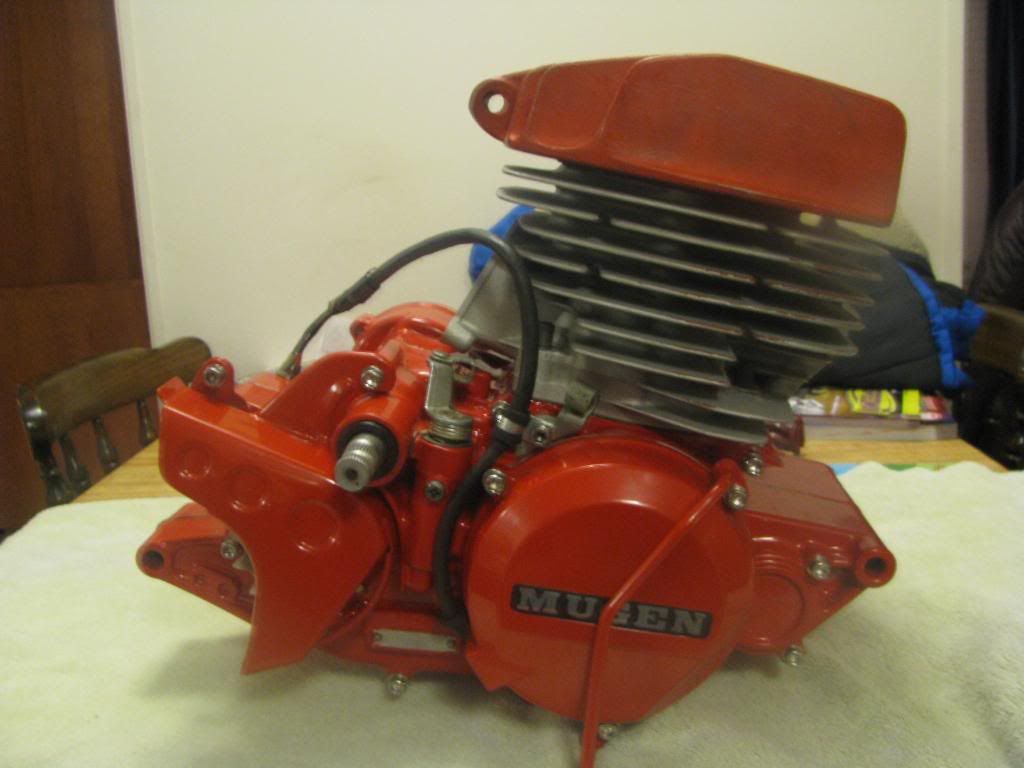

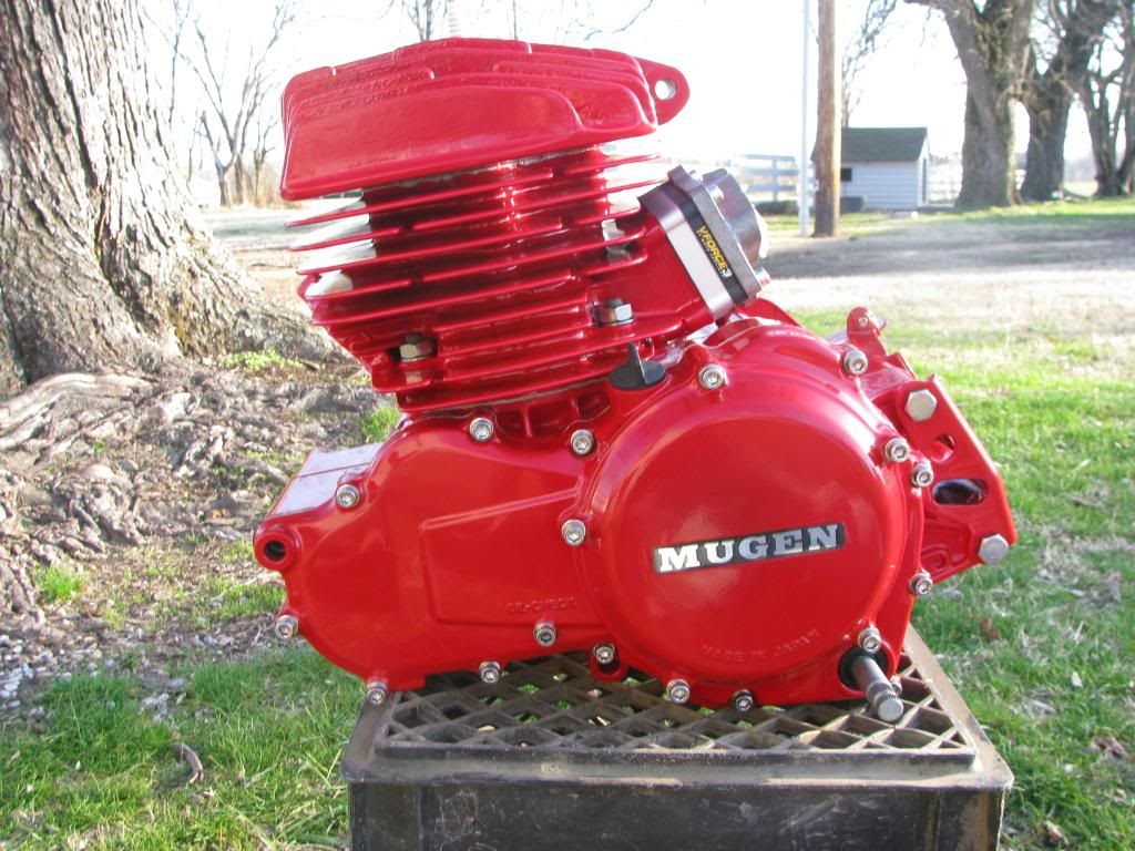

    Got the top end on today.

    I done a squish test on the top end and it came out to be too much so I took the head to the machine shop to have .025 took off it to get the squish in check. It's crazy to think that .025 would make a big difference but I want to get the most out of this engine. I called the guy that's plating my parts he's almost done. Maybe it won't be long now. I got 3 builds going on at the same time. I got parts laying everywhere in the barn. It looks like a honda shop exploded.
