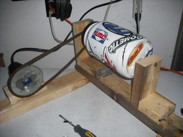

    okay so i tried making a tumbler with very little success. i seen that you used a rotisserie and i decided to go for that approach. it uses a powerful synchronous motor, but has a really low RPM. i figured with the low rpm, i would have to put it in for twice as long, but that didnt really work out. i used the grren triangles from harbour freight, the abrasive kind. anyway heres my original design
    heres a vid of it spinning

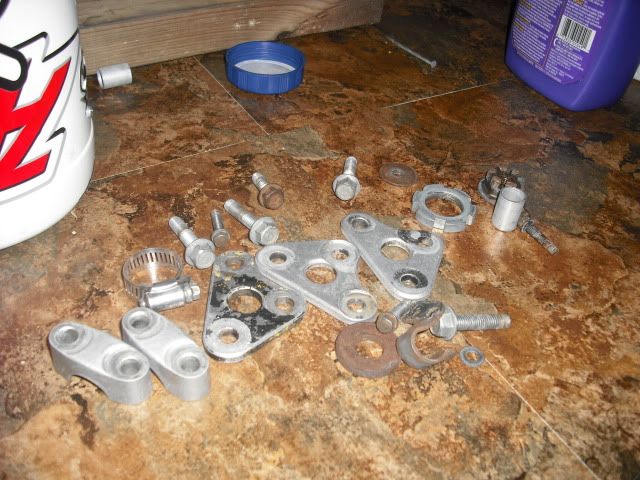

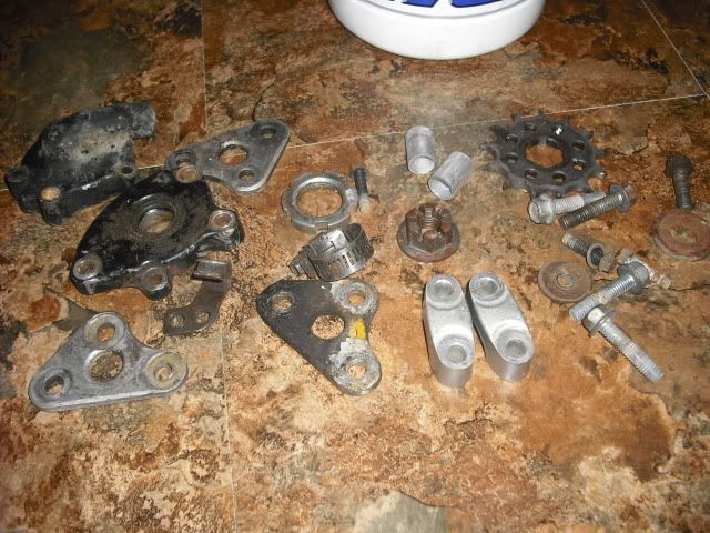

    parts before
    and after
    as you can see it didnt do a whole heck of alot, its just way too slow.

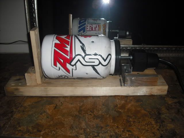

    so next i fitted my tumbler with some very advanced, big gear to little gear technology,
    and heres a vid
    but even still im not 100% sure its spinning fast enough. im a beginner tumbler so forgive me for my noobness.
