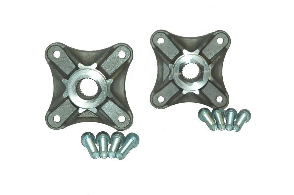

    Mudbogger and I are going in on 50 sets of 4/110 Dura Blue hubs for the 84-85 Tecate. We will sell them to members for $100 shipped to you
    This will allow you to use 4/110 Honda or late model Suzuki wheels on your 84-85 Tecate. The wheels are much easier to find and cheaper to buy. Most of us have sets of 4/110 wheels and tires around anyways.
    Here is a picture of what they will look like.
    If you want a set, let us know.
    Thanks for your time..

    Bad news on this guys.. Just got a random e-mail from Dura Blue. Looks like a no go (unless we can find someone to cut the splines for the hubs. Why do large companies like this lose things all the time? Bummed to say the least..
    "Hi Doug,
    I have not been able to locate our 13 spline broach (used to cut the spline inside the hub). We last used it over 7 years ago and it seems to have disappeared.
    I will not be able to make your hubs as I cannot make a new broach for such a limited number of parts.
    Here is a suggestion: if you can find a machine shop that can cut the internal spline, I can make the hubs (less the spline). There is a term for "single cutting the spline" but I don't recall what it is.
    I have not been able to find a source around here.
    At this point, I cannot help you.
    Gary"
