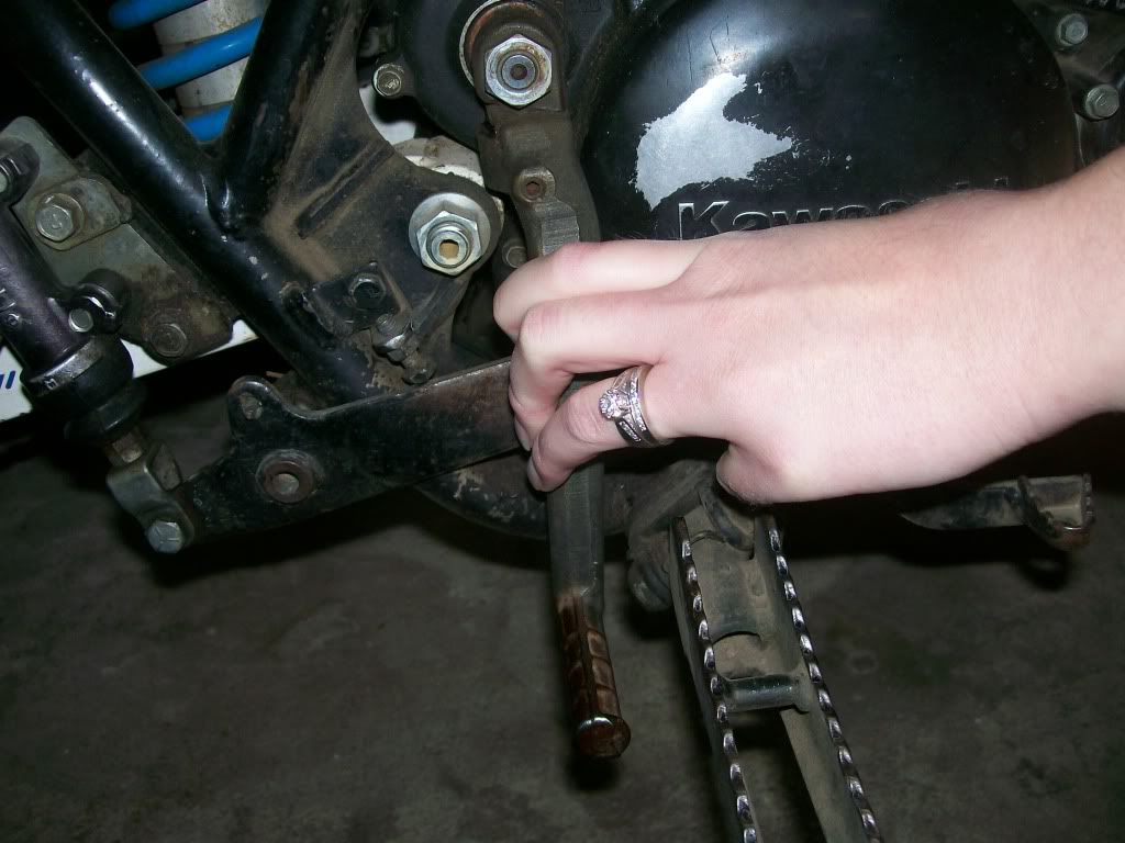

    I just went out to the garage, mine hits the case too when cycled by hand at the very end of the stroke. But when you kick it over by foot I don't think it will hit the case because the lever where your foot sits is a little below the footpeg. It doesn't contact the footpeg. There are no marks on my case where it does hit.

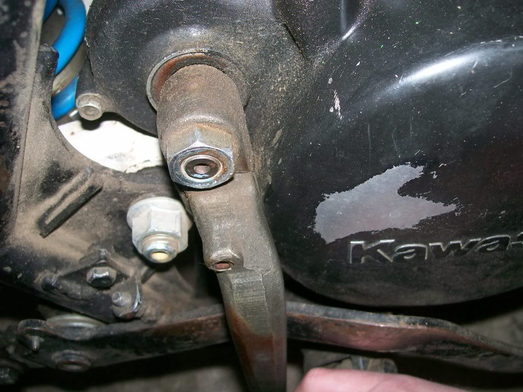

    Here's a pic of the kickstarter and case
    In this pic the kickstarter is touching the case, you can see how low the lever is relative to the peg.
