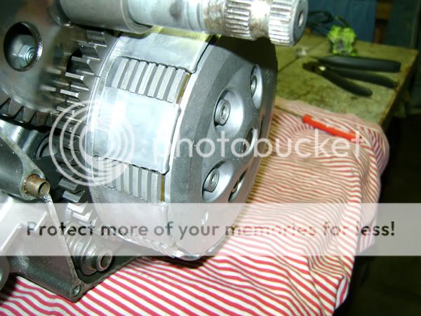

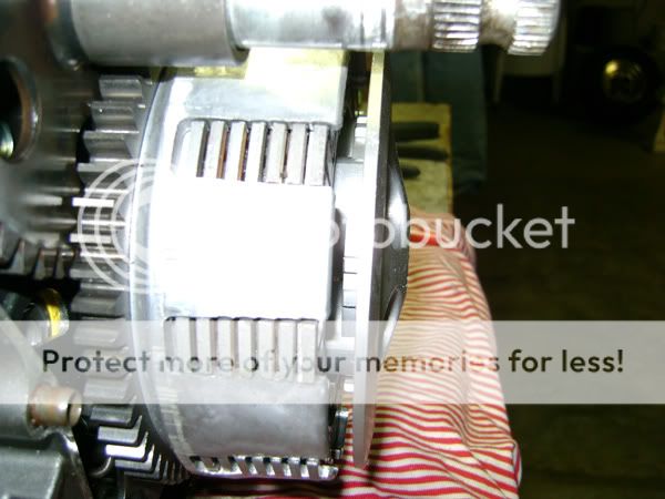

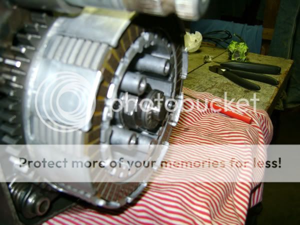

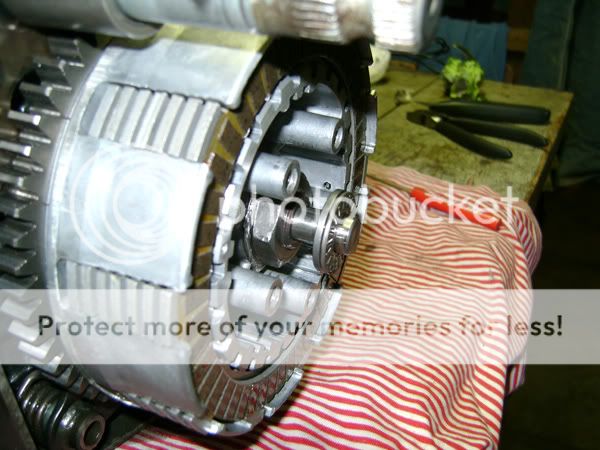

    in the process of putting my 250r motor back together and run into a problem. as stated in the manual at the end of the clutch rod there is supposed to be a ball
    when i took it a part there was no ball. so i ordered one and now when the ball is installed it will not let the lifter go in far enough and makes the plate stick out
    with the ball out
    with the ball in
    is it possible that someone has the wrong clutch rod in the motor? this thing is starting to get on my bad side haha
