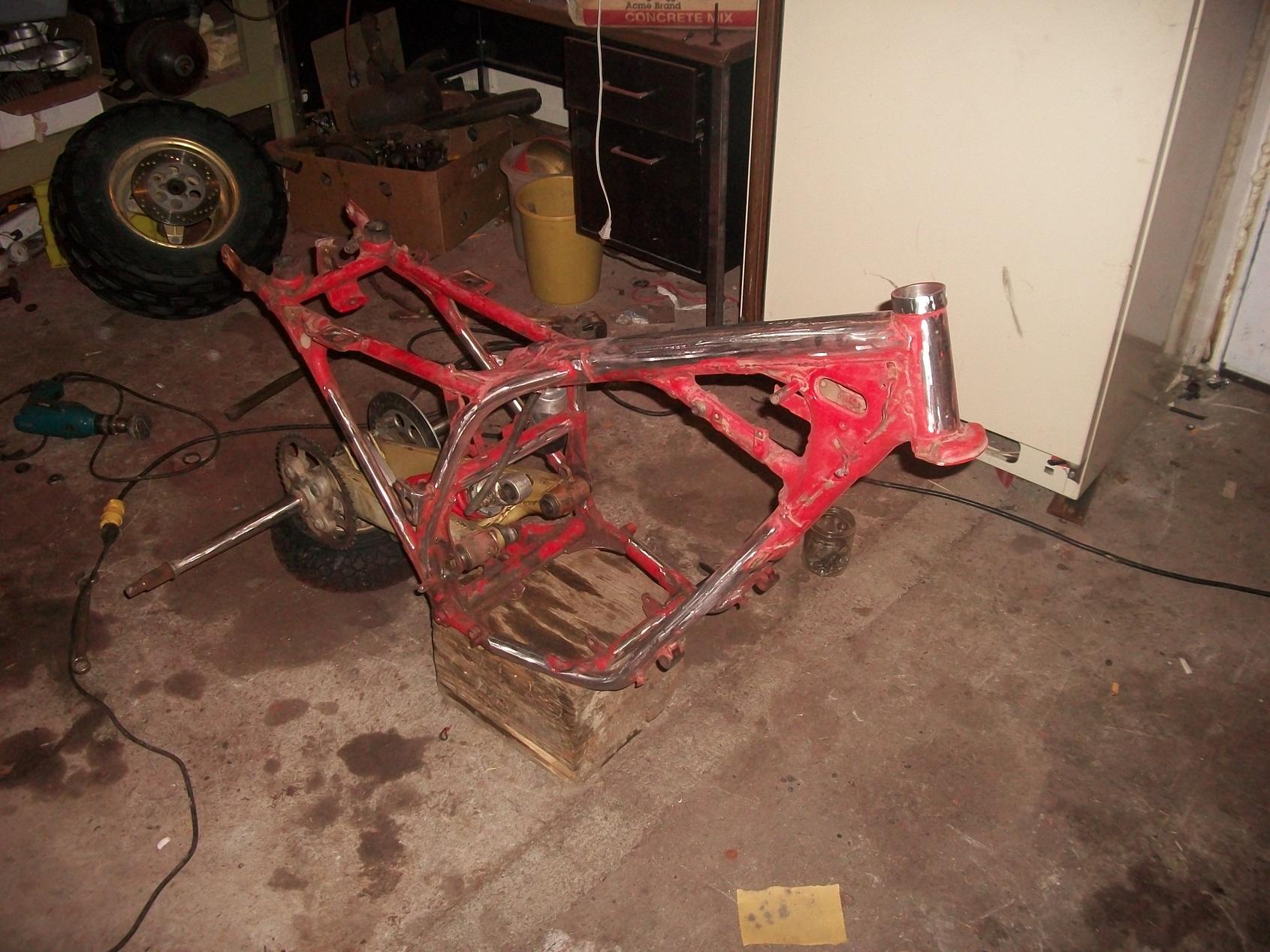

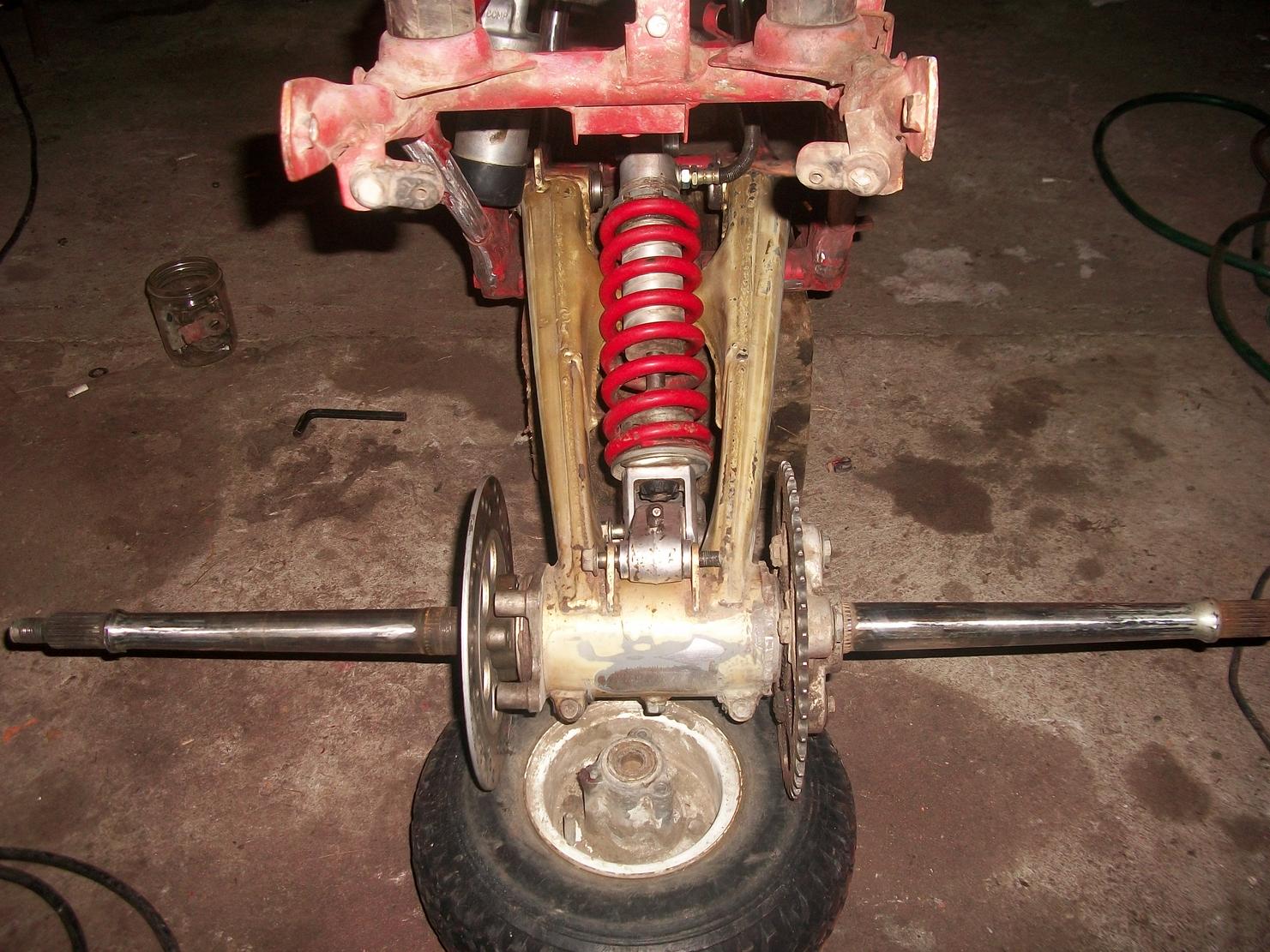

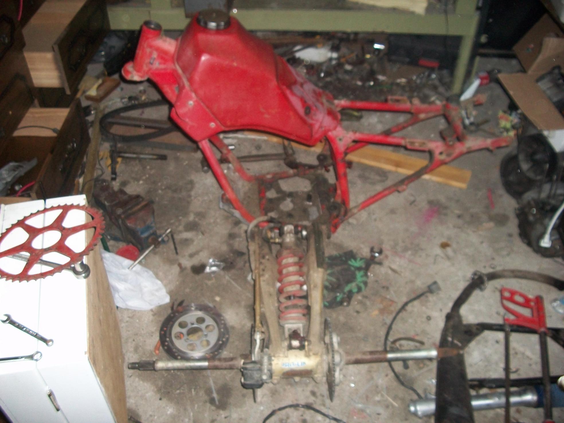

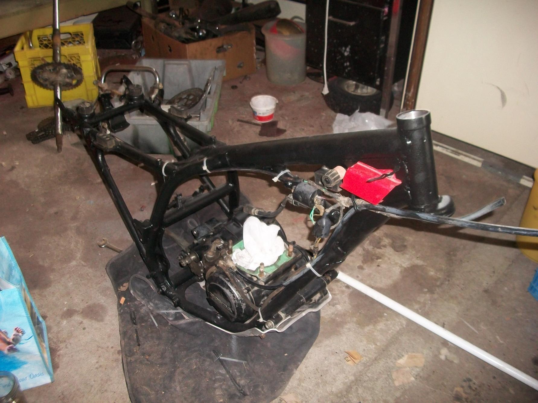

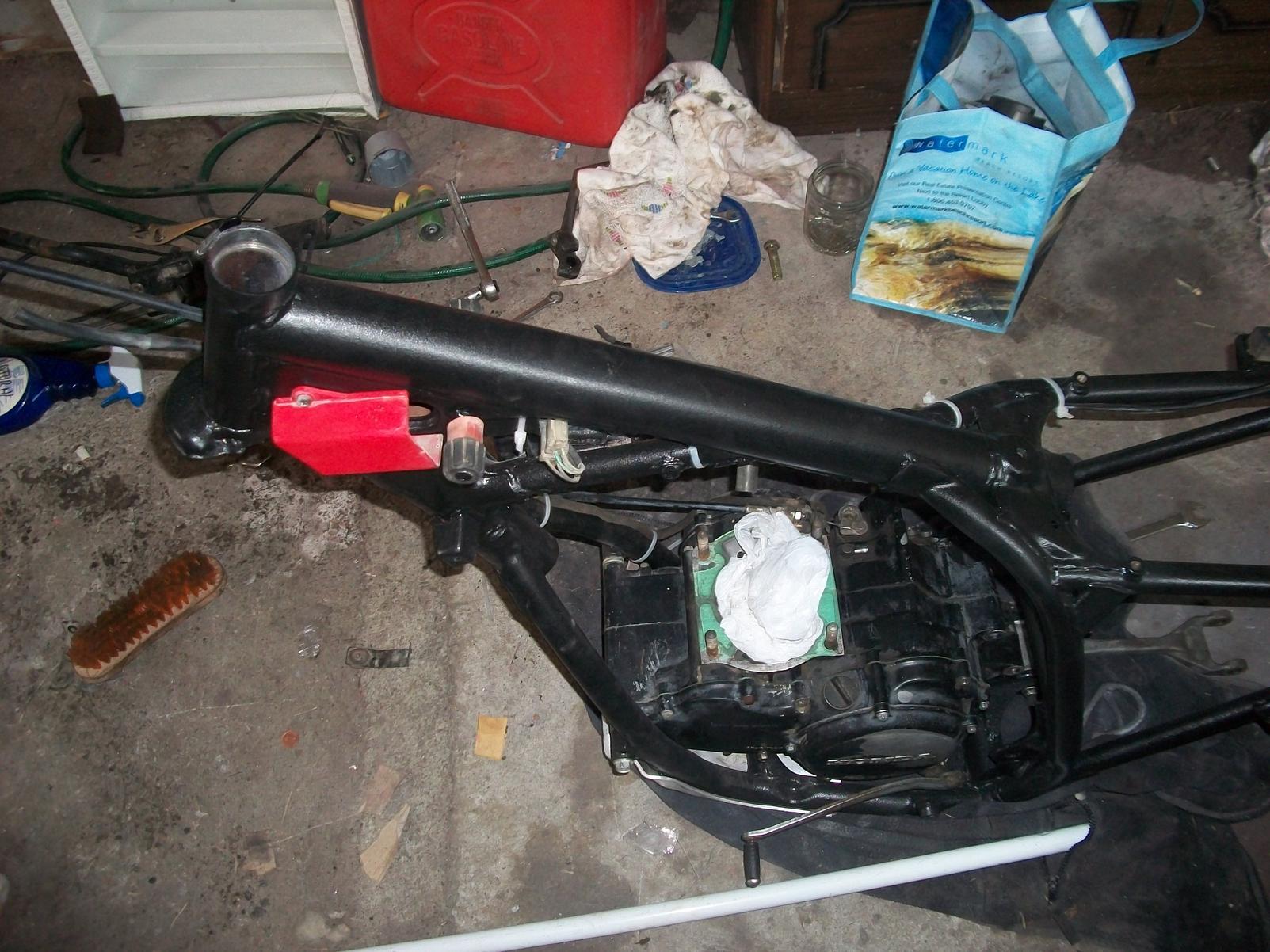

    pulled the axle out and the berrings where worse than i thought posible he said they never oiled it the axle is a little bent to we are looking for a used +2 i also started cleaning all the rust from the frame only found 1 crack on the swing arm but its not bad the color plan is black frame tank and plastics and metalic red rims we will start painting this weekend
    i slaped it back together for the pic

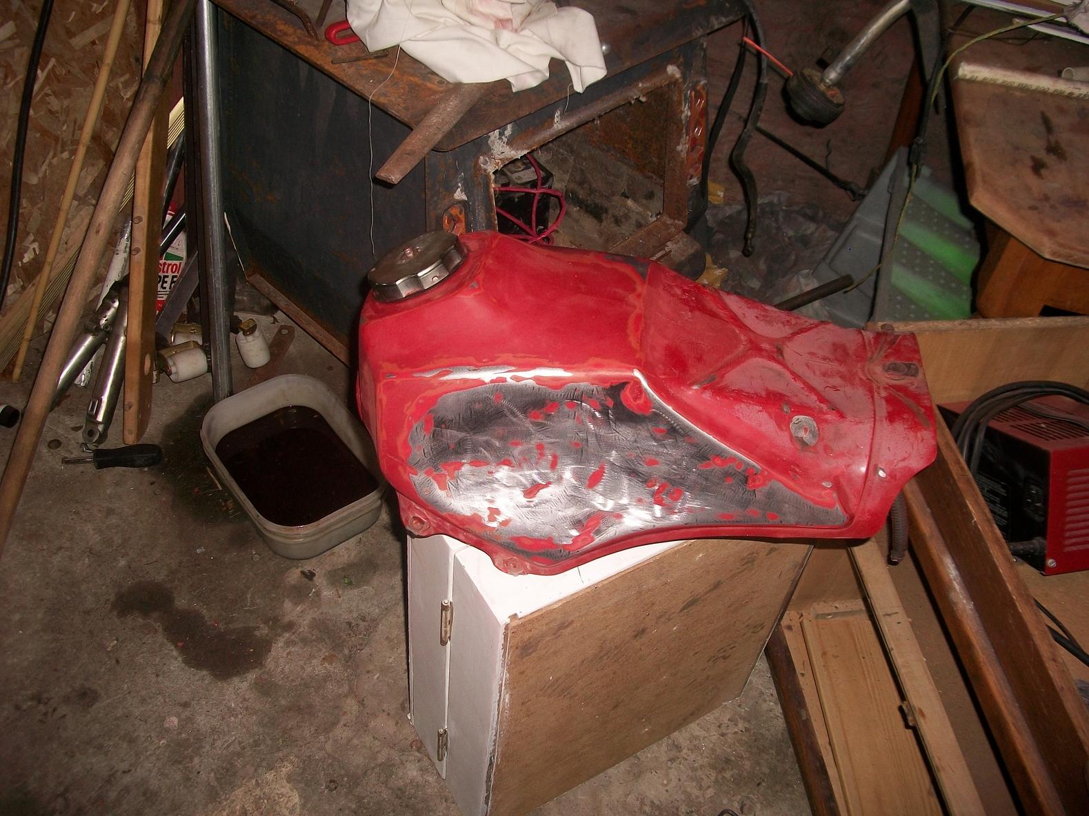

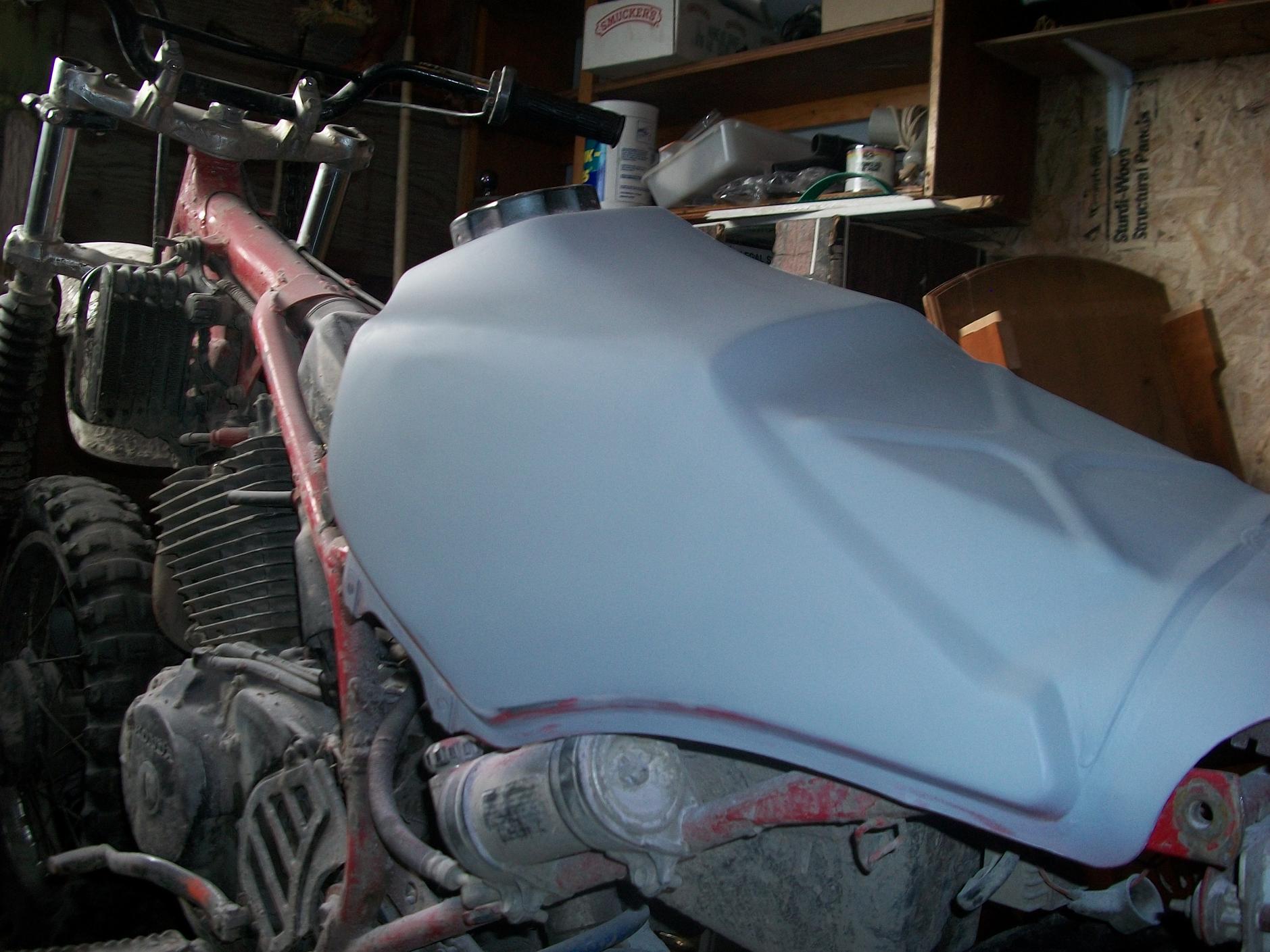

    got a bunch more work done this week the tank is only half done it still needs alot of work

    love the dirt bike front wheel lol
