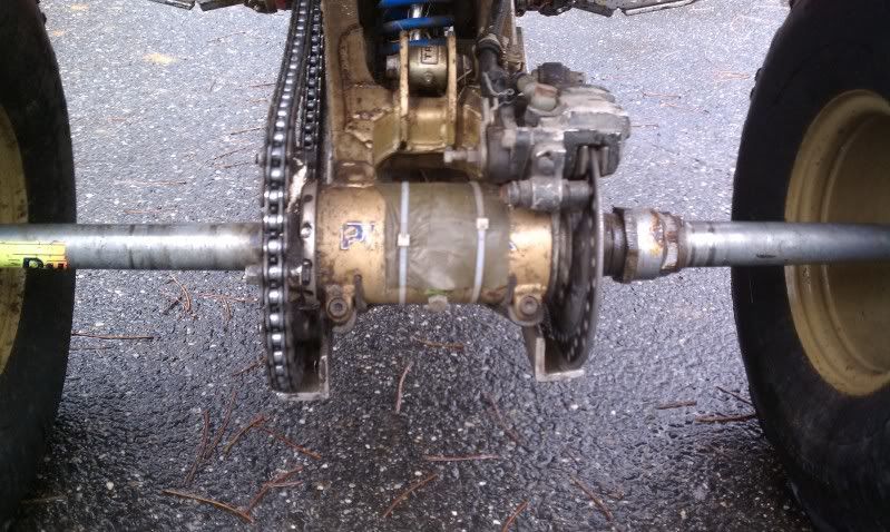

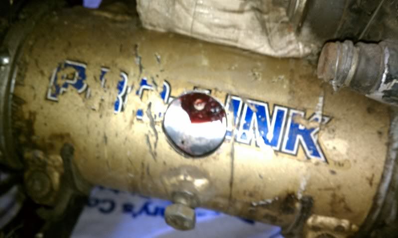

    Now here is one of my concerns…
    What the heck went on here?
    Did the guy do that so it’s easier to oil up the carrier?
    Good news, the rest of the swing arm does not have anything else wrong with it. No cracks or anything.
    Should I take the bike to a shop and get them to neatly weld on a plate to cover the hole up? I dont have a welder.

    Nice clean bike, and yes thats just what they did. Only thing i would worrie about is the water and such getting in there. Try to find some sort of rubber plug to seal off the hole. As far as weakness, there are a lot of bikes with swingarms built with open centers.

    nothing wrong with it.. i second x owner.... just find a plug and id spray alittle WD in it after every trip when id was the bike

    Whew that makes me feel better. I was worried that I had to replace the swinger

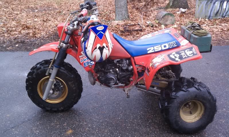

    you could slide those forks into their correct position. also, sweet toolbox!!!

    Quote Originally Posted by whipit View Post
    Actually it looks like someone removed the smaller of the two fork springs. Get a set of Progressive fork springs.
    What do you mean? does the front end need to be lowered?
    FastZ28, whats the benefit of those springs? It seems that the front suspension is working well. Then again, i haven't driven it hard since it has a bent axle.

    You won't want to spray WD-40 into the carrier, it will act as a solvent and dissolve the grease that is in there. Find a good marine grade grease, they will sell it at any marina. Its for boat trailers that get submerged in water and then driven down the freeway at 70 mph. Holds up awesome to water. A rubber plug and some marine grade grease and you'll be good. You would want to pop the rubber cap off after any wet rides to let any water that got in evaporate. Is there a small hole on the bottom of the carrier for water to drain out of if it gets in? Might want to add that otherwise it seems like water would get trapped in it.
