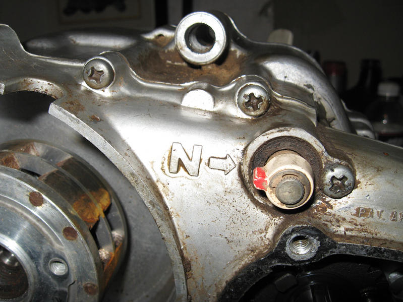

    I've been here before with other old motors, but I want to find out the best / proper way to remove the philips head case bolts? These ones are really cantankerous, and I've been unable to get them to "snap" free.
    Just don't want to tear out the threads.
    Just wondering if someone can provide me with a tried, tested, and true method for removing them, without serious damage, or resorting to vise-grips...or worse.

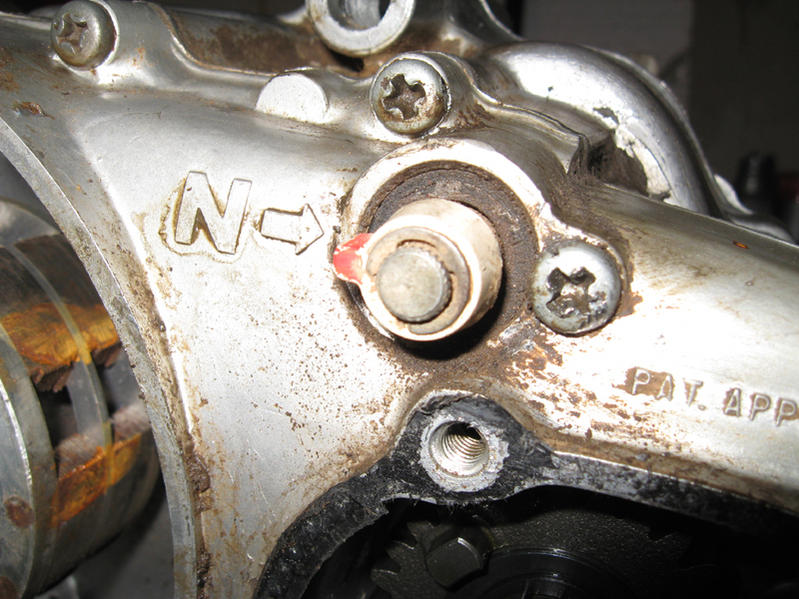

    Thanks for the suggestions...just gunna take some effort. As you can see, I started, using the biggest philips head bit I've got, using a 3/8's rachet, and it still started tearing out the head. I'll try laying the motor on its side and try attacking it from there! Maybe full body weight will be required, plus a little tap with Mr. Hammer.
