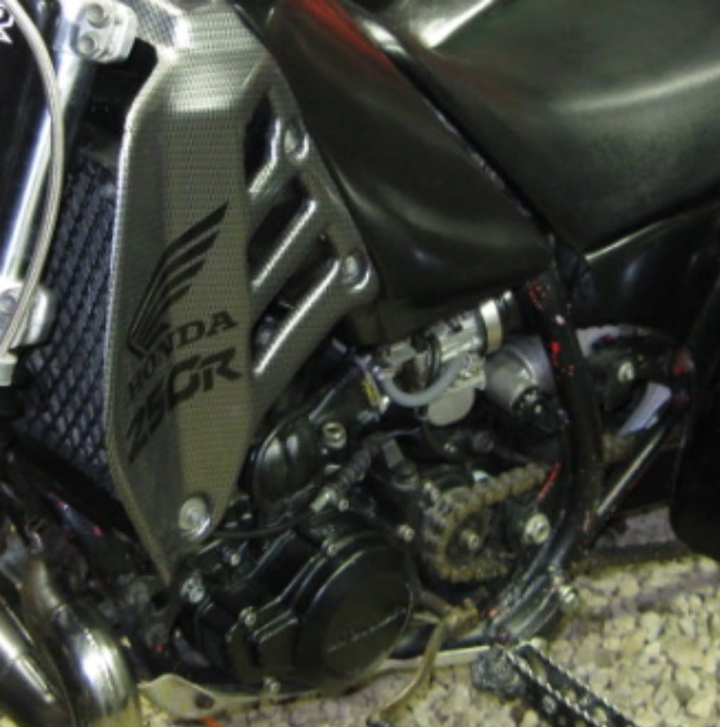

    There is a bracket right below the jug. One nut goes on one side of the bracket, and the other nut at the other side. That bracket is not threaded.
    Wind in you clutch lever screw almost all the way at the bars, then hook up your cable at the engine lever and get your rough adjustment in with the 2 threaded nuts on the cable at the engine bracket. Then adjust your clutch lever screw to obtain the proper slack in the cable.
    Generally there should be a nickles thin edge worth of free play between the clutch lever and bracket at the bars.

    Here is a pic of the lower mounting area.
