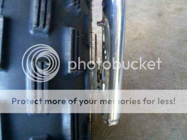

    Is there a differance between the offsets of the front tires of the 350x and the 250r? i went to mount my 350x front tire on my 250r forks and found out when i tighten the shaft down the studs for the rotor hit the fork.
    its like i need a 1/4in spacer on this side of the shaft. you can see i dont have it tightened down so i can still roll the trike around

    If youre using the 350x hub on the 250R -then thats your problem cause theyre slightly different but look identical.

    well damnit lol will the 250r hub fit the 350x rim?

    yes....it will.

    I had to use the 250R front wheel with SS collars and a SS bolt made by Ronnie............
