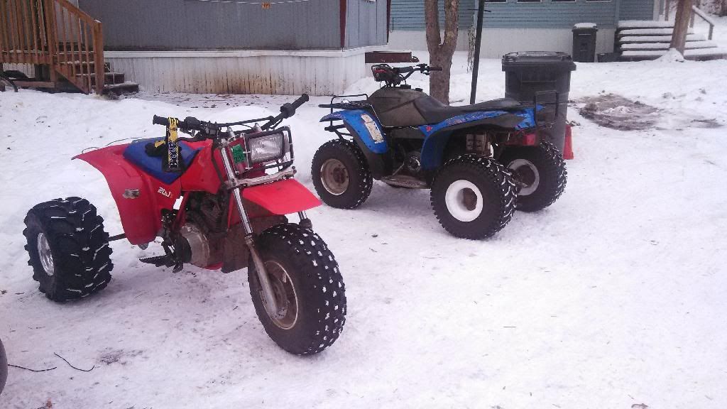

    Here's my 85 Auto-X. 82 ATC200 motor. I run a 200X carb with pod filter. +4 swinger & 2" hub extensions with Bear Claws.
    I have a second motor that's getting tore down for a rebuild with all the performance goodies. Also working on a custom DG aluminum exhaust. I did buy a 14 tooth front sprocket because first gear is pointless in the snow and mud. Hoping to get a little more out of the low gears. Haven't installed it yet though. Photo taken yesterday during a -20 degree ride.

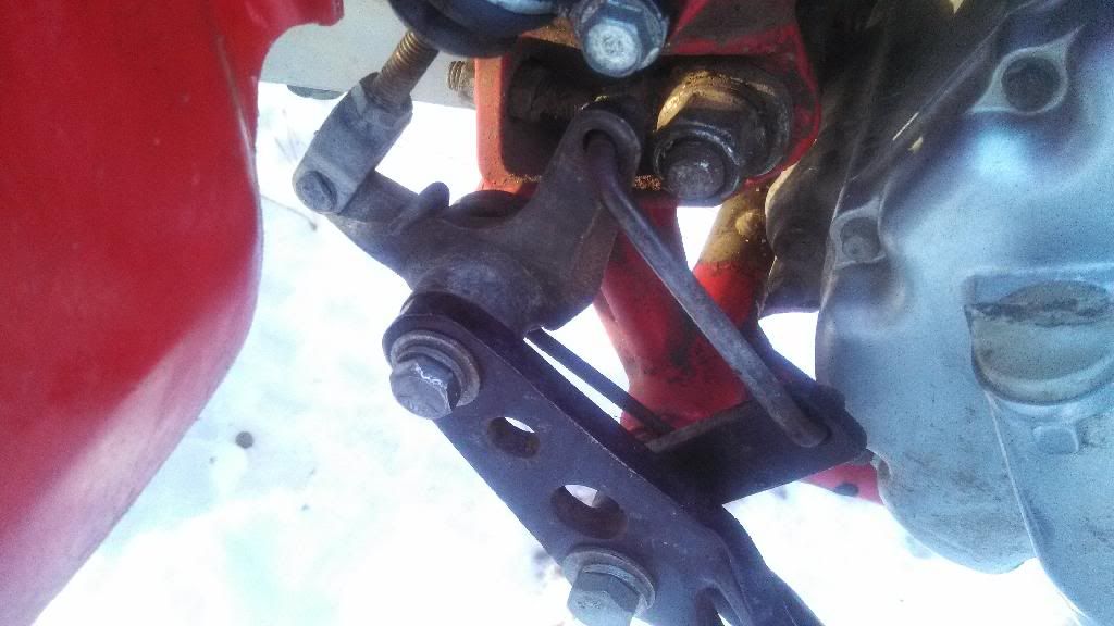

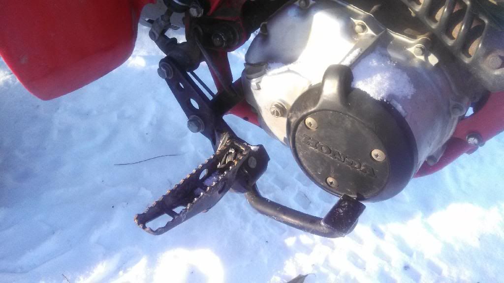

    Here's my brake pedal setup. Don't know the story on it. I bought the machine this way. If anyone can identify it. That would be awesome. I know Veal commented on it once but I don't think he knew either.
