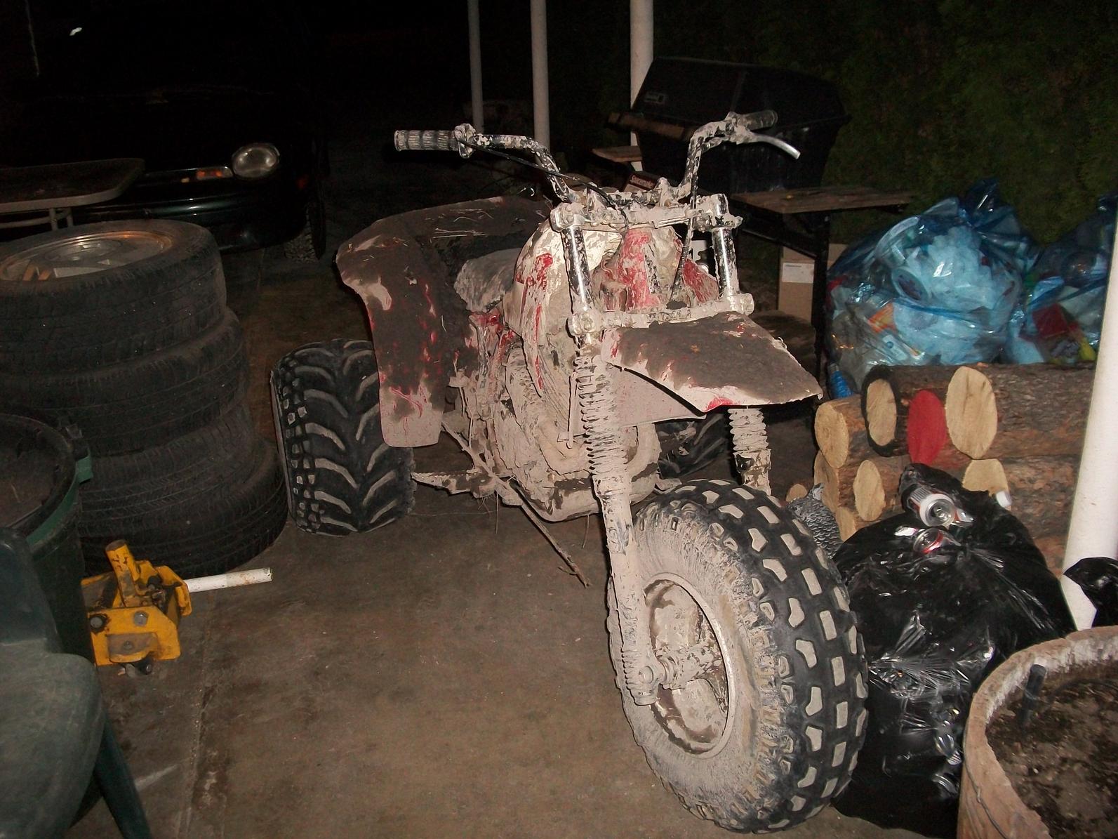

  5. #35
    osoyoos bc canada
    1,057
    here it is the front end is back on the 250R now tomas was just borrowing them after his crash
