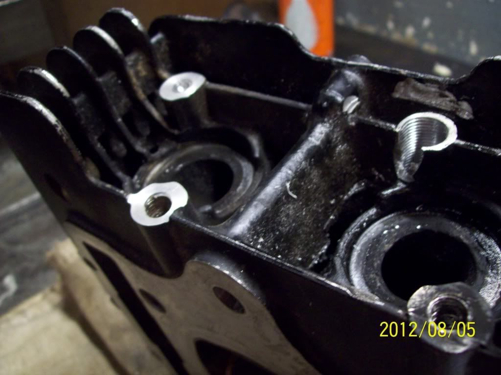

    Got a picture of the casting boss by chance? Not too clear on what you mean by that.
    17,460
    Just look at your head, what does the stud go into? It will be obvious......
    Get your flashlight out!
    Boss meaning "raised and cast area for a specific hole"........
    Jan 2011
    Philly Burbs
    72
    Thanks. Trikes at my buddies house and never looked at it real close to see what it actually looked like. Appreciate the help. Is the big hole one of the ones you were in the process of fixing? Do you do a heli-coil type of thing or just a stud with big threads on the bottom and the normal size up high?
