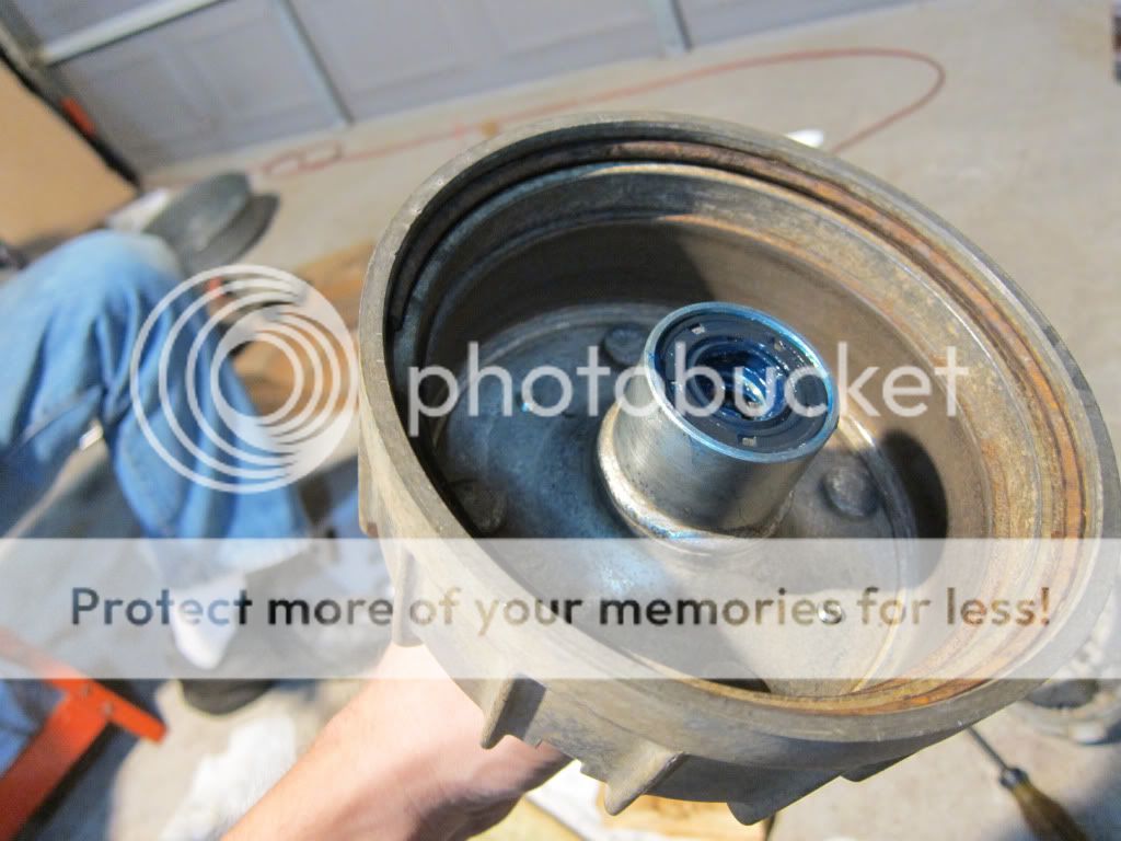

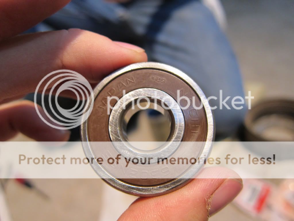

    I think we are talking about the same thing. The Bearing that is supposed to look like this?
    That goes in here
    Like So
    Unless by shot you mean the bearing has fallen apart and all that is left is the outer race? If that is the case I am not exactly sure what to tell you. I used a long thing punch and knocked the bearing out from the opposite side. The bearings were no longer good so I wasn't worried about messing them up. Once you get the first one out the 2nd one is much easier.
