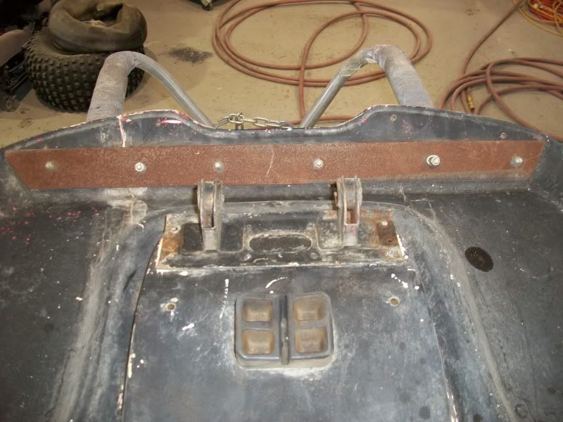

    This is the large piece of steel that had been bolted to the underside of the fender to keep it from breaking by the previous owner.

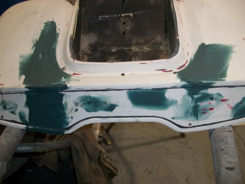

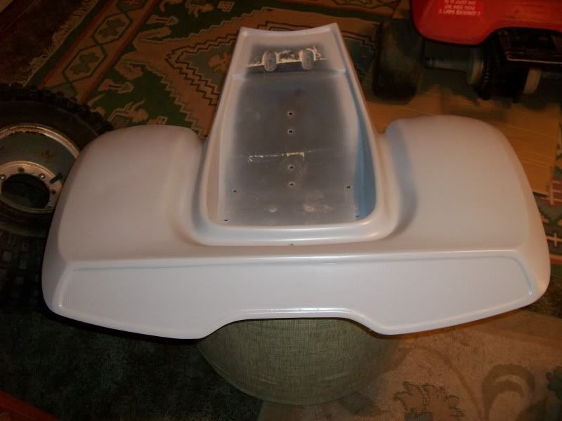

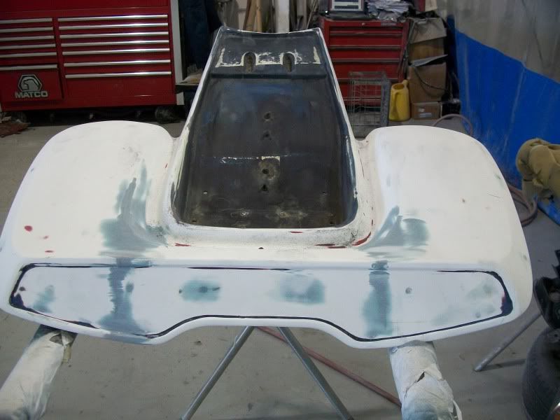

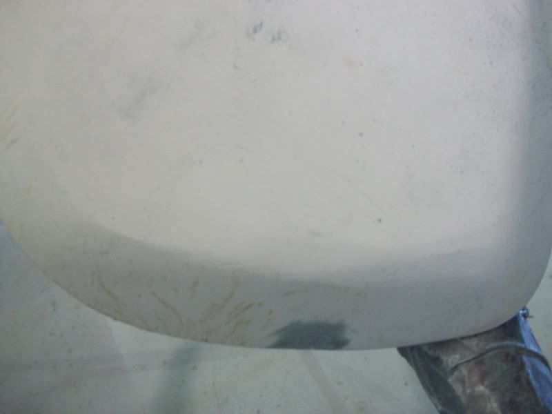

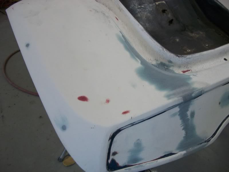

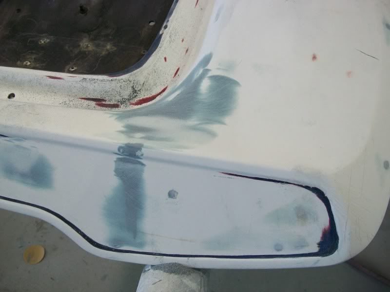

    Here are a few pictures I took with the fiberglass filler on the fenders and some with it sanded and then in primer.
