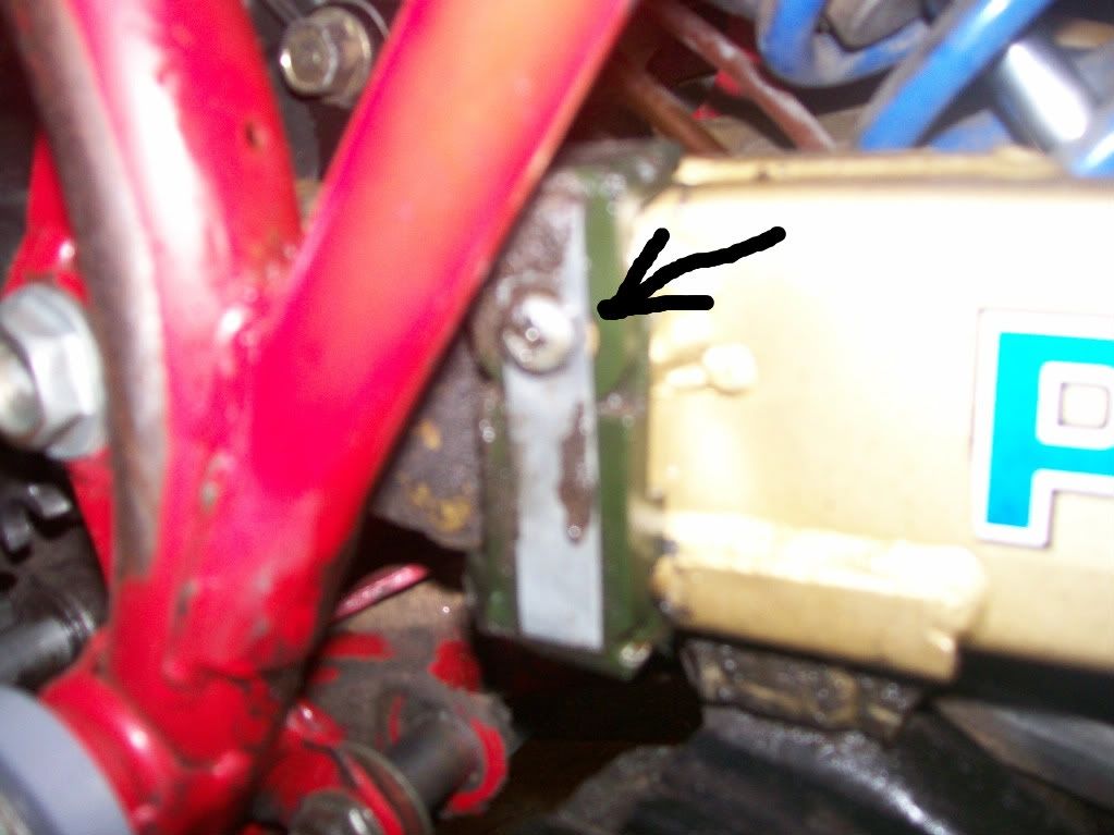

    First off, I have a manual. My guess would be that Honda was too ashamed to explain what a mess this was going to turn out to be. First off it's a Phillips head screw to remove the chain rubber at the front of the swingarm. I would think that a bad idea to begin with. Second, to put it right behind the "V" in the frame..? I mean come on.. So I put the bike up on a jack to let the rear droop, but I can't get on the screw straight and I'd hate to strip it (Why wasn't this a bolt again). I had my wife sit on the bike hoping the screw would clear the rear leg of the subframe so I could remove the screw.. not even close.
    So do I gather up a dozen or so neighbors to sit on the back of the 250R so I can get to the screw. Please don't tell me I have to pull the swingarm, or pull the shock to get to this screw head.
    Does anyone have any insight as to how to get this screw out? I've bought more new tools since I bought this 250R..
    Sorry to hear about your issues you're having with this. On the bright side, Honda must have taken notice of this less than satisfactory design, because they changed it on the 88-89 TRX swingarms.
    Check it out, they ditched the phillips head screw in favor of a bolt, and they put it where you can get to it too!

    Thanks guys.. Especially Ross. After looking at what a PITA it would be to remove the top shock bolt, I instead took the easy way out and pulled the bottom shock bolt. It drooped with way more than enough room. Got the screw out, new part, and put a brand new bolt in it.. WOOT!!
