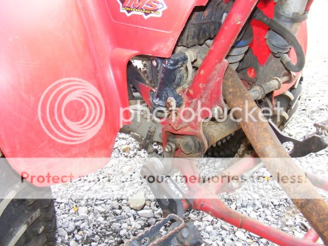

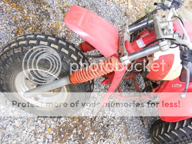

    I know I've said I wasn't going to get anymore but I made an exception this 1 time. Found it sitting behind a guys house that I used to know and stopped to ask about it. I ending up trading for it and brought it home. I've still got a China 200cc electric start engine that manual clutch and has reverse that might find it's way into the chassis.
    The good:
    Pretty good fenders and seat (OEM front fender and seat)
    Suspension is good
    Plastic tank
    9" rear wheels (not badly bent up, going on the 350X)
    Good tires, no cracking and holding air
    Complete engine, 80 psi on the compression gauge
    frame is straight
    Nice complete DG exhaust for my other 200X
    The bad:
    Master cylinders are no good
    No rear caliper, wrong rear master cylinder
    No headlight
    Levers and perches no good
    Mismatched thumb are throttle
    No carb
    Unknown condition of ignition stuff

    Heck ya. You can upgrade to that china motor, the X motor is junk anyhow, and have electric start, that'd be cool. If your chinese is a Lifan, the DG exhaust will mount up, or the stocker off other X. That tank, as said, is cool and the rest is there. Perches are cheap, I've loaned 200x perches to friends to us on Chinese 110 dirtbikes and they fit. Can have a nice runner for cheap. And as for brakes I've read on here that they're way over rated anyhow, just make sure you let your kids ride and test how fast and good the trike runs with out brakes before you get on it, don't want ya getting hurt.
    Crest California
    3,014
    I say toss it all together and see what you get. No need to throw away a perfectly good engine if it works well.

    I was doing really good too, I hadn't bought a trike in like 4 weeks. I even walked on a 350X parts bike yesterday (complete except for plastic and seat). the timing was good on this one. The wife was gone to town with the kid and I was able to get it home and into the shop without her seeing it. She came out in the shop when she got home and didn't even notice this one was new but I had it in the back of the shop with the 70's up against it, LOL.
    Tell me more about the tank, I didn't even know it was plastic until I started taking the pictures at home. It does have an IMS filler cap but the shourds don't fit well.
    South Florida
    6,804
    The need to turn the forks past the stock turning point was needed in race conditions so IMS made this tank and it was great and held up good for MX also . Most people used aftermarket shrouds (maier or SRP) so fitment was as good as the installer LOL . Stock 200x tanks fell apart in MX conditions , the tank ears would bend and crack .
