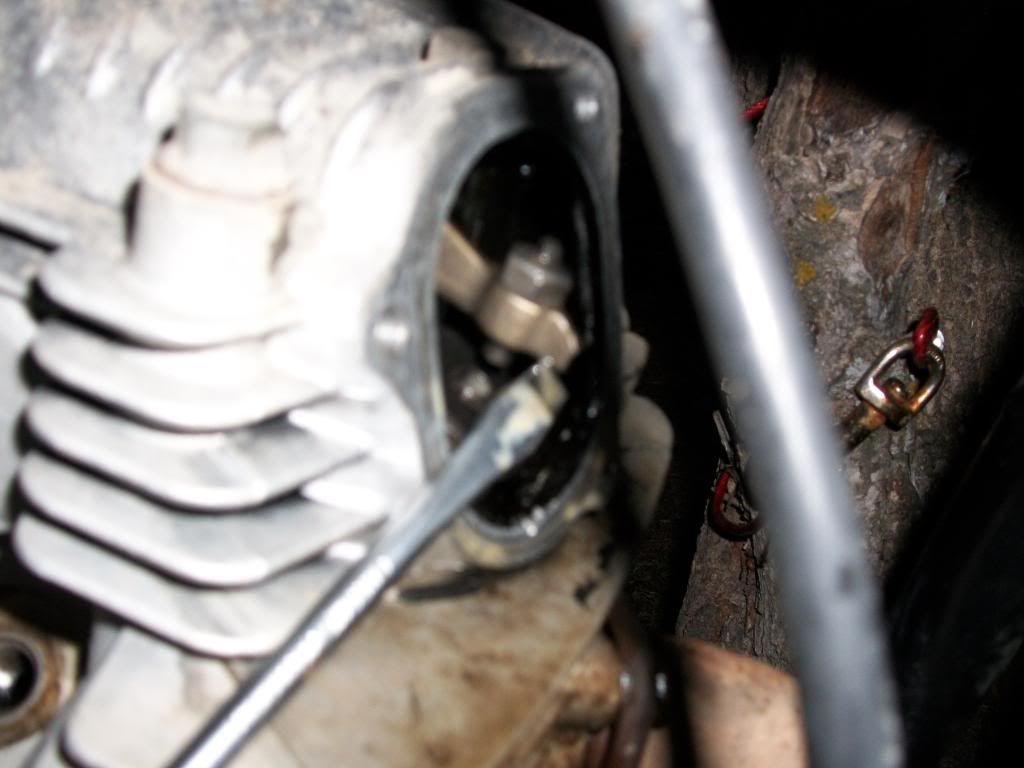

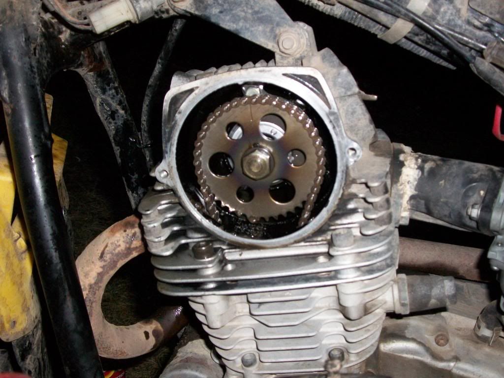

    Explaining what is happening is kind of hard so I went a took a few pictures of what is going on.
    The Engine timing looks right to me
    You can see here how much I can lift the rocker? arm.

    looks like your gonna have to pull the head.if the valve is stuck you should be able to see it.
