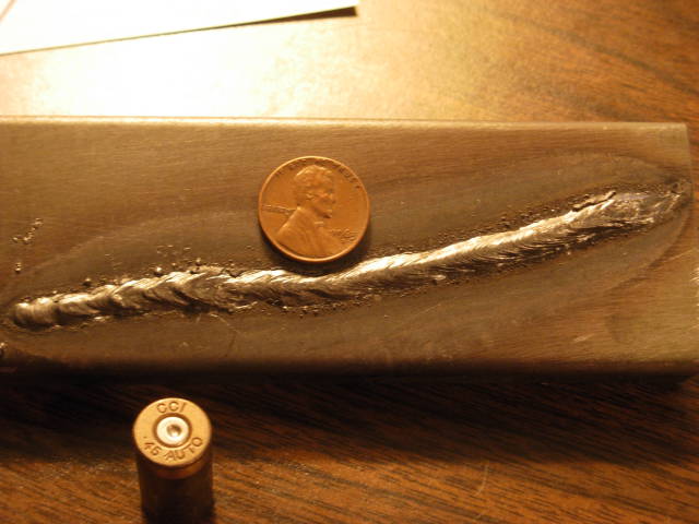

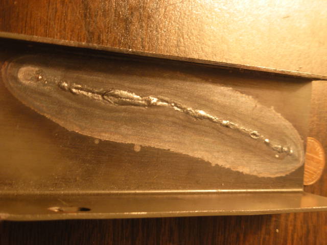

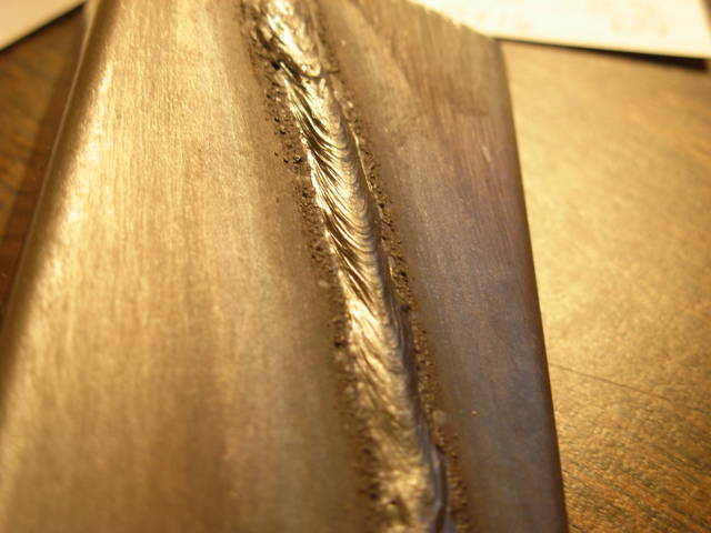

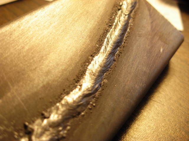

    Here are some pics of a weld I quickly threw down
    It's 6013 1/16 rod, can't tell you the amps I was welding at, cause my welders so old the painted on dial has rusted away , I just go buy feel and visual checks of what welds the best. But any way, I just posted these up cause of you go this route you'll know what weld quality to expect.(It was prolly running a smidge to hot in the pics)

    Nice, I know what rods I'm using lol.
    Gonna have to buy some and practice before the next pipe. Although. With the next pipe. I'll probably be tack welding everything with the arc and finishing it off with the mig, doubt my dad wants me to use all his gas lol. But i wont lie, i could use some serious practicing lol.
    I've got some 6011 1/16 rod but it blows through everything, I haven't tried them on the 18 gauge yet, but I'm going to test them. I bet i end up getting 6013 rods.
    I'm going to be looking for some 20 guage steel, the 18 is heavy, almost as heavy as the stock pipe lol.
    Thanks a ton for the pictures and help!
