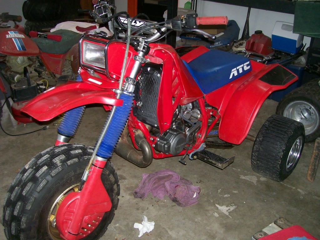

    Do 1986/87 trx 250r footpegs interchange with 1985/86 atc 250r footpegs?
    Im looking for wider footpegs for my 1985 atc 250r and I’m wording if I can just buy 86-87 trx 250r footpegs and mount them up.

    Pretty sure you can get footpeg adapters to use 450r pegs.

    No they do not interchange, and im sure you could make adapters for 450r pegs, but it would be easiest to order a set of wideners that bolts onto the factory pegs. If you want to use 450r pegs than I would say the easiest way would be to cut the stock pegs off of the mounts on your R and weld the peg section of a 450r to the stock R mount.

    Talk to Jason Hall at 3wo....Im sure he makes nadapters to use 450r aftermarket pegs

    Jason Hall does make the adapters. I have blingstar notorious pegs on my 250r
    17,493
    I made a set for my 350X that uses 450R pegs. The plates are 3/8's thick and I love the way they feel, no more sloppy ole pegs for me

    Those look awesome. Is the peg position close to factory? Im definitely going to run some modern footpegs. Sloppy peg are terrible

    Would anyone be willing to make some of those atc250r-trx450r adapters?
    I PM'ed Jason about this a few months ago and he never got back to me.
