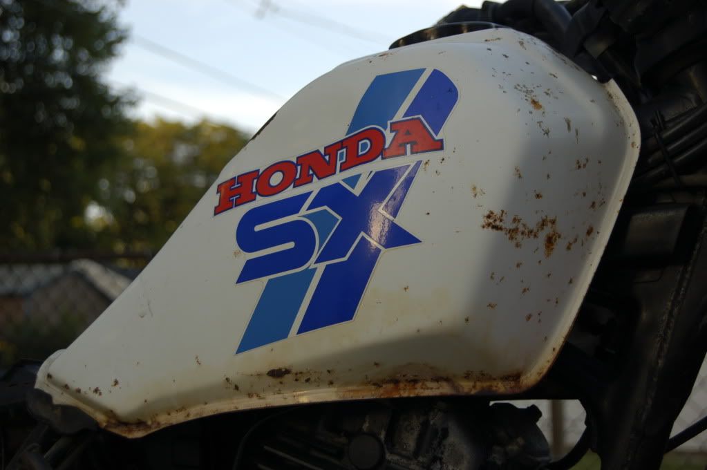

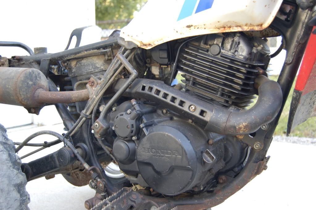

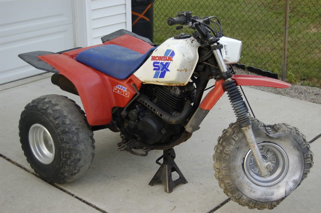

    I just picked this up tonight off of craigslist. 1986 250SX. I little dirty and not perfect, but I think in pretty good shape.
    The good:

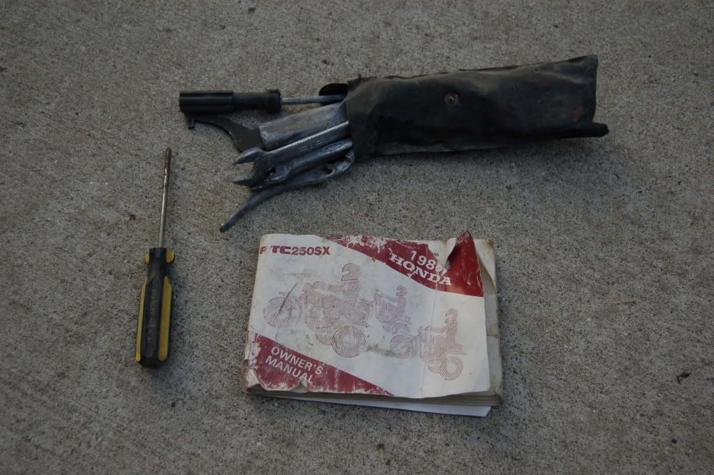

    - Complete down to the owners manual and tools

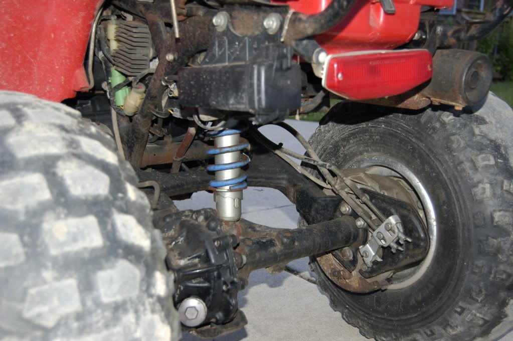

    - Diff lube was nice and black (as opposed to milky white.. so no water).
    - Engine oil looked decent
    - No major bends or breaks
    The bad:
    - Gas Tank. It holds gas but weeps a bit at the seams.
    - Front tire: toast
    - Rear tires: bald (but hold air)
    - Fenders: small crack in corner by trunk
    - Vaccumed out the critter nest from the airbox (took the nest and all the foam from the stock aircleaner which was completely toast)
    When I got it home, I took the pictures, then put about a gallon of gas into the bone dry tank. I opened the petcock and the float bowl drain to flush out the bowl a bit. I then hooked up a battery with jumper cables (oh yea, no battery) and this thing just came back to life in about 5 seconds.
    So, some more good:
    - Runs (in fact, it starts really well)
    - Lights all work
    - Reverse and forward gears are ok (for the 10 seconds of driving you get before the front tire goes flat again)
    I'm going to do a complete carb cleanout and change all fluids. The biggest thing is I have to figure out what to do with the tank.
    Question about the gas tank: On a tank with no obvious holes, but definitely leaking, can I get away with one of the gas tank lining kits? Or when I etch it, will my weaping spots turn into full blown holes? I'm kinda bummed about the leaking gas tank, but overall, I think it was a good deal.

    Yeah, it will seal up just fine wonderboy.
    In fact, where the heck you at in s.e. Michigan ? I have a bigred tank ready to drop off to my local motor gut uptown to seal for me. His deal was I buy the stuff (red coat + muriatic acid) he will do it for a couple of recent favors owed.
    There certainly is enough sealant in a quart of red coat to do tanks,,, more like 4 or 5 tanks can be done so hey, my treat man, we just gotta figure out where each of us are at and hook up.

    Nothin' to lose by trying to seal the tank.
    por 15 is real convincing stuff, and lots of pro and cons for the others.
    My sx tank looked the same and when I sanded down those paint bubbles, there was nothing left.
    I mean you could stick 4 fingers into the tank.
    I wish I sealed it in retrospect but found a whole sx parts trike with a good tank for 100$.

    Mint..for $450 you scored. Engine and all the major components look good. Besides the back tires being spun off the thing it looks like under a bit of rust and neglect you may have a really low hours machine..
    Little or no wear on the side of the engine casing, same on the sides of the tank..all the little pieces are there (tool kit, clutch adjust screw cap, exhaust heat shield)!! This thing hasn't been riden much for sure!!
